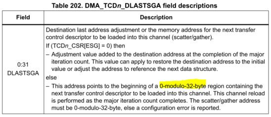

i'm working with spc570s and using gnu free gccc in spc5studio.
In my program I need to apply __attribute__(( aligned(32))) to an const struct variable.
I tried like this but it does't work.
for example.
typedef struct
uint32_t aa;
uint 32_ bb;
}A
static const A ***[2]  __attribute__(( aligned(32)))
i want to allocate *** with starting address 0xdddddd00(20,40, 60).
Thank you in advance.
    How did you determine it doesn't work ?
    Not sure what that is supposed to mean.
    __align__ (32) means an address divisible by 32, i.e. the least significant 5 bits are zero.
    With writing "0xdddddd00", you seem to assume the last 8 bits are zero, i.e. align (256).
    HIm
    HImAuthor
    February 12, 2020
    ​I compiled and checked the address of the variable in the map file. start address of variable is 0xddddddF0.
    I want the starting address of one of variable to be located at an address that starts with an even number as 32(0x20)byte boundrary( i.e. 0xddddddE0, 0xddddddC0).

    First, align the structure, not the variable. See https://gcc.gnu.org/onlinedocs/gcc/Common-Type-Attributes.html#index-aligned-type-attribute. For example
    typedef struct
     uint32_t first;
     uint32_t second;
    } __attribute__((aligned(32))) myStruct_t;
    myStruct_t myStruct[2];
    Next, control its placement in memory. Your post suggests you've already done this somehow. Otherwise for example
    myStruct_t myStruct[2] __attribute__((section(".myDevice")));
    And in your linker command file
    MEMORY
    <snip>
     MY_DEVICE (rw) : ORIGIN = 0xdddddd00, LENGTH = 64
    SECTIONS
    <snip>
     .myDevice (NOLOAD) :
     *(.myDevice)
     } >MY_DEVICE
    Finally, as you're accessing a device of some kind and the number and order of bus accesses is probably significant, you ought tell the compiler that with a volatile qualification on each of the structure members, for example
    typedef struct
     volatile uint32_t first;
     volatile uint32_t second;
