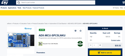

I was able to solve this problem by uninstalling USB driver and re-installing USB driver, so now, I can program and debug SPC58NH-DISP using AEK-MCU-SPC5LNKU(debugger) and UDE Starterkit 5.02.04.

you should buy AEK-MCU-SPC5LNKU, dedicated to PLS UDE.
https://estore.st.com/en/aek-mcu-spc5lnku-cpn.html
