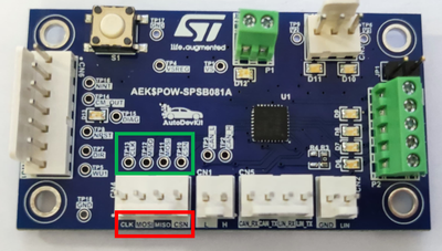

Errata label mismatch on AEK-POW-SPSB081
Max VIZZINI
Dear community members,
In the AEK-POW-SPSB081 board, the SPI pin labels (red box in the below image) are not matching the labels of the test points.
The correct labels are those placed on the test points (green box).
Thank you for your contributions.
