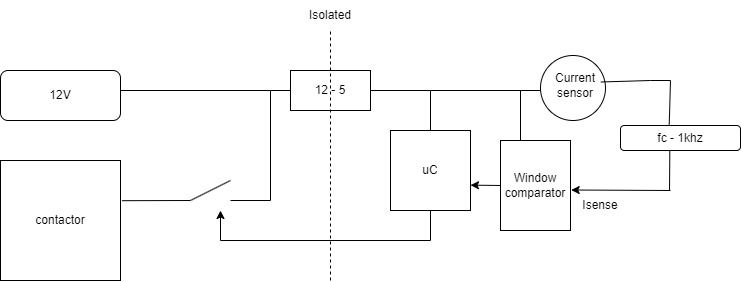

Project - Battery connected to load/charger with contactor on the positive terminal of the battery and current is monitored, whenever the current is above threshold contactor should be turned off.
Objective is to whenever the current sensor output (DHAB 118, unipolar hall effect ) crosses the threshold comparator should give microcontroller an interrupt signal indicating the short circuit current. I have configured TS334 in window comparator configuration for detecting the overcurrent, wiring diagram of how its done is shown in the image attached.

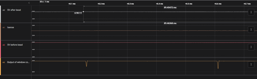

Problem being faced is comparator is giving false triggering as shown in the saleae capture.

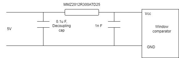

    5 V line is connected to the comparator with the ferrite bead and the low pass capacitor ( 1nF, to avoid resonant frequency) and the test was conducted, the problem remain the same - The output of the comparator goes low whenever contactor is switched ON (only during at that moment) as shown in the sampled data which is attached below. kindly help in solving this issue.

    Well, you just put in a block diagram. It is not clear from this how you have wired the input of the window comparator, nor the exact wiring (line lengths, type of wiring, etc). As already mentioned, the input of the TS334 has a very high impedance, so it can easily pick up conducted or other disturbances.
    Also, it is not possible to see what kind of contact is being switched. The fact that the pulse appears exactly when the contact is switched suggests inductive interference or a current pulse.

    Update - The power supply provided to the comparator was disturbed when contactor was driven which has caused the comparator output to go low.
