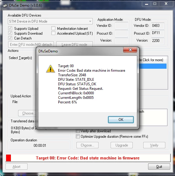

Not an error state that I'm familiar with, would look at .HEX and .DFU involved. ​
Tesla DeLorean
Guru
Mar 2, 2019 2:32 PM UTC
Try STM32 Cube Programmer it also supports USB/DFU connectivity. ​

I am facing same problem even if I generated file using the upload button in  the software and try to upgrade this file in stm32l432kc again, Any suggestion to solve this issue
swapnil champaneria
Mar 4, 2019 8:51 AM UTC
@Community member​  Thanks for replay, In stm32 cube program my device not detected in dfu mode

Try upgrading the ST-Link firmware first.

My proposal is for the case when STM32CubeProgrammer is used. Is your device detected after updating the ST-Link firmware?

OP Attempting to connect in USB/DFU mode, NOT as ST-LINK

Could you plz try with last version of STM32CubeProgrammer :2.1.0.
Tested for my side and it is OK.
Please  let me know if you still have the same issue.

I know this is an old thread, but I'm having the same issue. I believe my problem is with USB signal integrity. In my case, I changed layers on the USB traces on a 4-layer board with a ground and power plane. The return path for the USB signals has to find the nearest bypass capacitor which is 0.25" away. I may also need to monkey with my trace width to get closer to 90 Ohms (Right now I'm at 100 Ohms).
