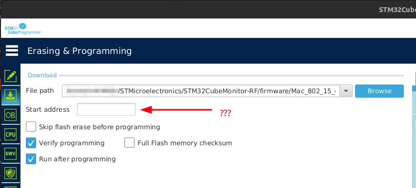

What is the start address to flash the Mac_802_15_4_Sniffer_Dongle.bin?
I'm trying to configure the STM32WB55 Nucleo Pack USB Dongle with the Mac_802_15_4_Sniffer_Dongle.bin but the Start Address is empty:
What value goes here?

Hello @m4l490n ,
You can use the standard start address 0x08000000 to flash the firmware.
Maryem.
