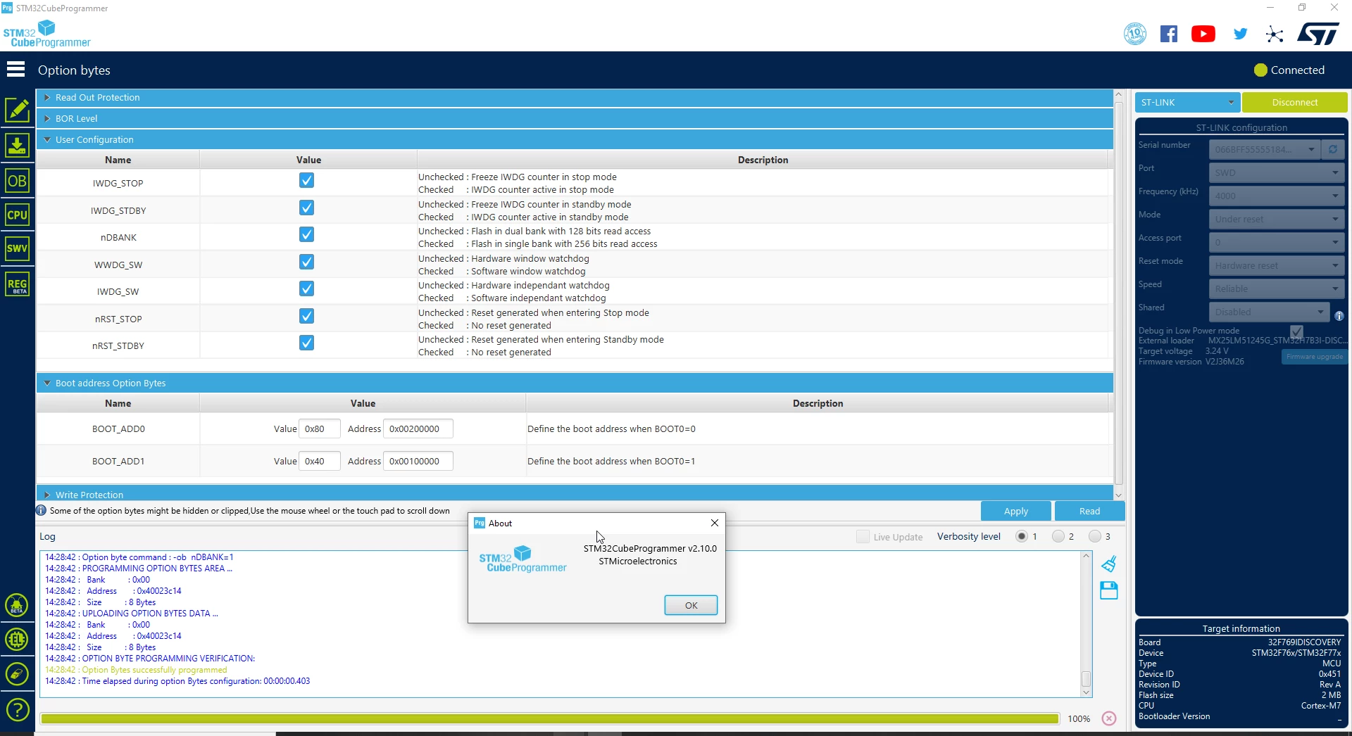

We use dual boot on a stm32F7 MCU and set the nDBOOT option via STM32CubeProgrammer. Now I downloaded the latest version of the tool, but the nDBOOT option does not show anymore, thus I cannot enable dual boot.

The problem is that I cannot disable nDBOOT with the latest Stm32CubeProgrammer because the option does not show up under option bytes. It works just fine with the old version of STM32CubeProgrammer that I used before.
Apr 22, 2022 1:32 PM UTC
Can you please share your screenshot to compare with mine ?

The nDBANK and nDBOOT are two separate flags and your image is missing the nDBOOT.

Your screenshot does not show nDBOOT either.

You are right ! ndBoot OB is missing in user configuration TAB,
I raise this issue internally to be fixed in CubeProgrammer future release.
Internal ticket number: 126991(PS: This is an internal tracking number and is not accessible or usable by customers).
Thanks to highlight this issue.

I'm using STM32_Programmer_CLI to program the STM32F76x and have issue to program the nDBoot option byte.
It shows up in STM32CubeProgrammer , but STM32_Programmer_CLI does not .
I think it is probably related to this  problem . Do you know solution for this ?

Hello @marcde,
Welcome to ST Community !
Correction hasn't been done yet for 1 MB flash size targets, the issue will be fixed in the next release of STM32CubeProgrammer.
Internal ticket number: 158507 (PS: This is an internal tracking number and is not accessible or usable by customers).
