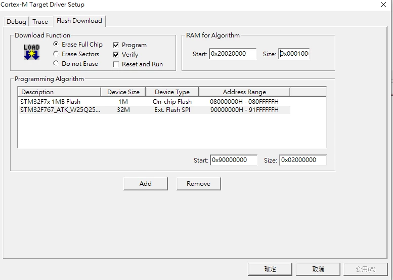

Via following the Keil official document(Programming External Flash used with STM32 Devices MDK Tutorial ), I write a Keil MDK external flash for the custom STM32F767 board. Erase Chip and Program are done but verify encounters errors (Contents misma

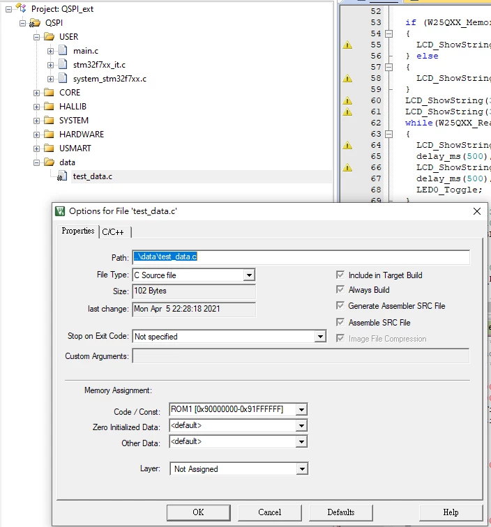

In order to test the external loader algorithm, I add a test data to a QSPI project that can be excuted correctly when downloaded to the internal flash. The test data will be written in the external flash via the external download algorithm.
0693W000008yjLQQAY.pngThere are two algorithms in the QSPI project, one is for internal flash and the other is for external flash

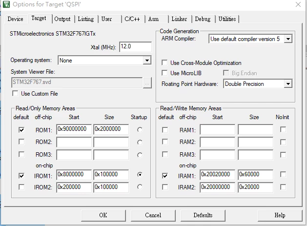

The setting of target option in the QSPI MDK project is shown as following:
0693W000008yjLzQAI.png And the scatter(QSPI.sct) file is shown as following:
; *** Scatter-Loading Description File generated by uVision ***
LR_IROM1 0x08000000 0x00100000 { ; load region size_region
 ER_IROM1 0x08000000 0x00100000 { ; load address = execution address
 *.o (RESET, +First)
 *(InRoot$$Sections)
 .ANY (+RO)
 .ANY (+XO)
 RW_IRAM1 0x20020000 0x00060000 { ; RW data
 .ANY (+RW +ZI)
LR_ROM1 0x90000000 0x02000000 {
 ER_ROM1 0x90000000 0x02000000 { ; load address = execution address
 test_data.o (+RO)
 .ANY (+RO)

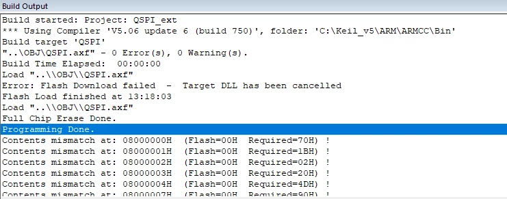

0693W000008yjMOQAY.pngIt shows that Erase Chip and Program are done, but encounters errors “Contents mismatch at: 08000000H (Flash=00H Required=70H) !�?while Verifying.

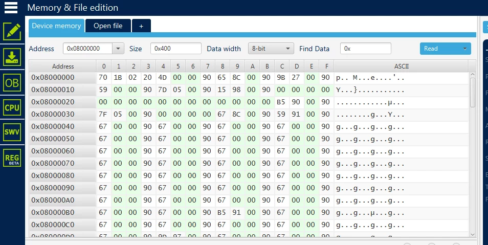

I use CubeProgrammer to read interal flash, it shows that the data the internal flash is correctly. I suggest that the Verify function for internal flash is not running properly.
