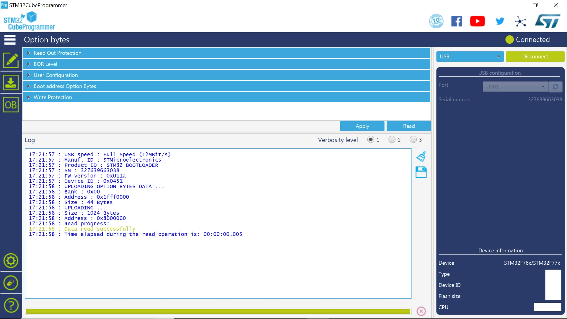

Unable to connect (& hence flash the firmware) the STM32-Cube-Programmer with STM32-target-board in USB-DFU-mode if loaded firmware is read-protected.
1) I am able to connect the STM32-Cube-Programmer in USB-DFU-mode if existing or loaded firmware in to STM32-target-board is not read-protected.
Image-1: Able to connect with target board

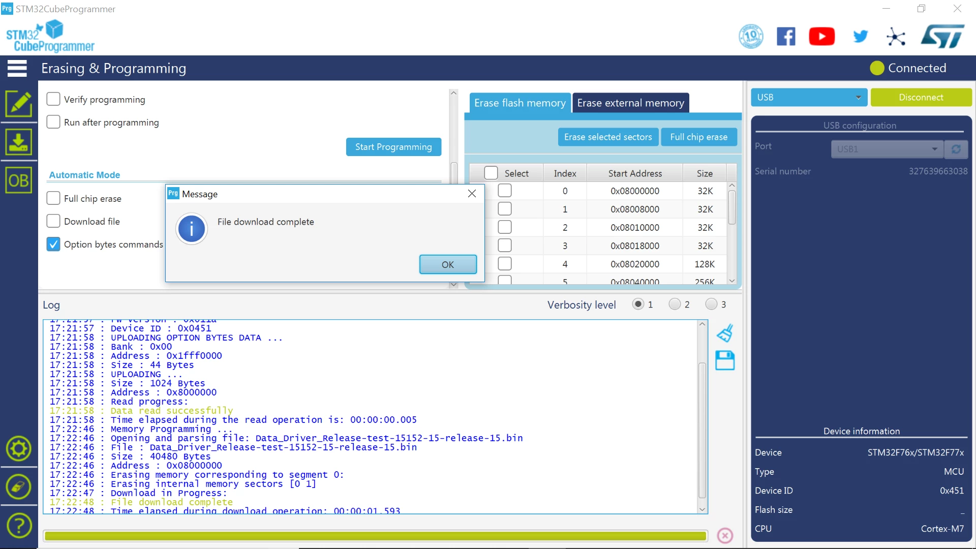

Image-2: Able to load firmware in to target board

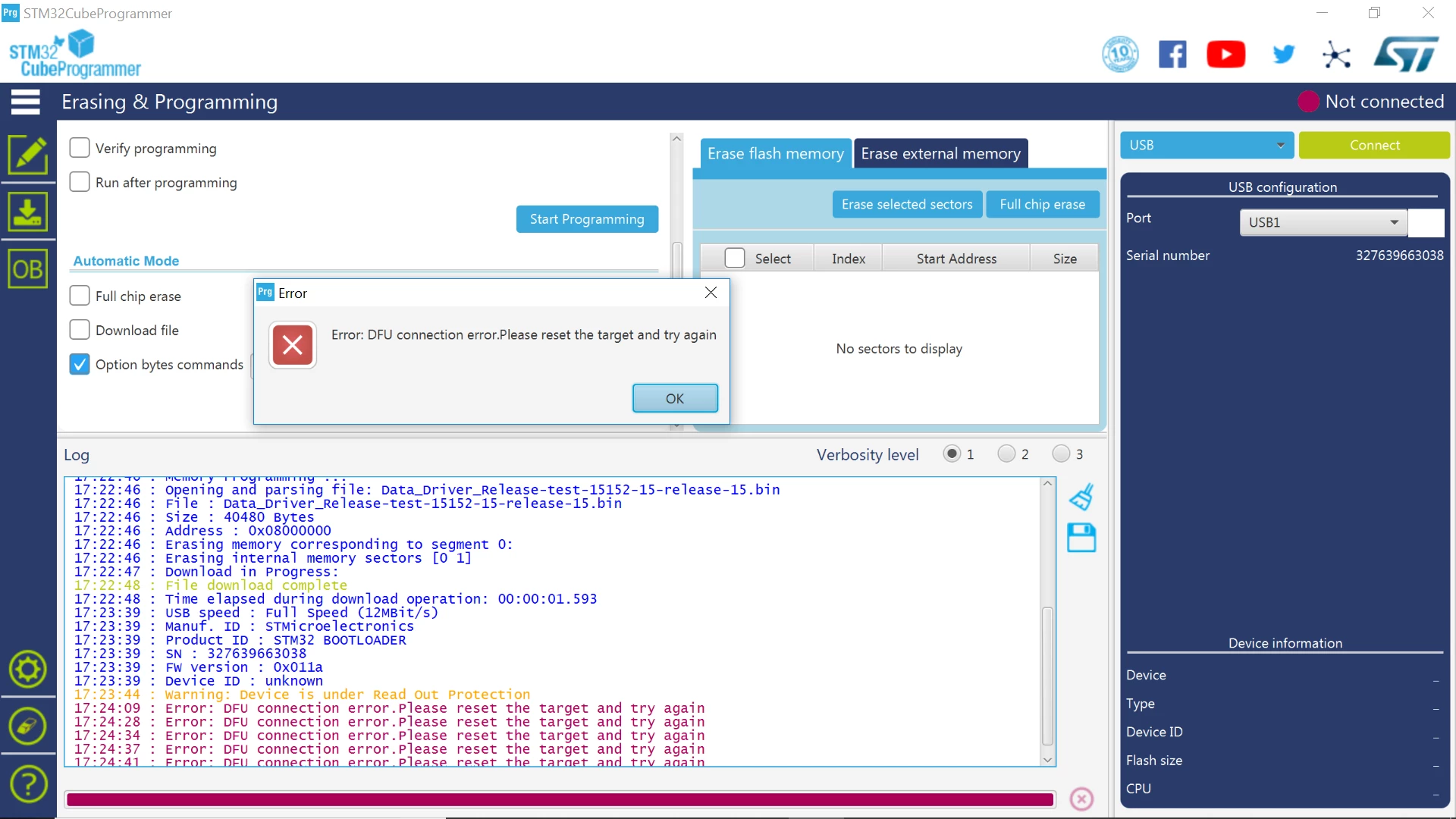

2) I am not able to connect the STM32-Cube-Programmer in USB-DFU-mode if existing or loaded firmware in to STM32-target-board is read-protected.
Image-3: Not even able to connect with target board0690X000009Z7rUQAS.png
In this case I am keep getting the DFU connection error,
How to resolve this application bug.

Can you try another dfu program, as Tormod Volden dfu-util? Does "dfu-uti -l" list the the device when in DFU mode and protected? Then you can erase and rewrite the option with dfu-util.
LPosl
Visitor II
Aug 2, 2019 8:13 PM UTC
I have exactly the same case with STM32F042 and current STM32CubeProgrammer tool. I'm new to STM32 - my first design now. Tried on 2 PCs. I wasted time on trying a few tools, DfuSE does not see anything, dfu-utl see the chip but I had no clue how to remove the lock. Finally I went to CubeProgrammer folder, and toticed that there is command line version of the tool which I run with following command:
STM32_Programmer_CLI.exe -C port:usb1 -rdu
and got device back in read Level 0 protection

There appears to be a bug in stm32cubeprogrammer when trying to connect to the usb bootloader when connecting directly to the onboard USB 2 or USB 3 ports for about half of the stm32f469 micros I've tested with in Windows 10 at least.
If I use a usb 3 hub in between the stm32 device and the onboard USB ports the connection works! Some USB 2 hubs work and some dont so something is very wacky. I have verified this behaviour with a windows laptop, 2 windows desktops, and multiple windows 10 tablets.
The other half of the stm32f469 devices work just fine without the hub connecting directly to the onboard USB ports.
So quickfix is to use a usb 3 hub instead of the onboard Usb ports.

I'm having the same issue, @nirav soni​ and @Beachmiles​ are reporting, and I can confirm what @Beachmiles​ said: The same USB DFU device, on the same PC behaves differently in the following scenarios:
  • plugged through an USB HUB: The STM32CubeProgrammer detects the STM32 BOOTLOADER device and is able to connect properly, performing FW update
  • plugged directly in the USB port of the PC: the STM32CubeProgrammer cannot connect to the device since is detected as "read protected"
This is a serious issue for our company, since we cannot perform FW update of our devices on the field if the user does not have an USB HUB with is PC.
Do you have an update on this topic?
