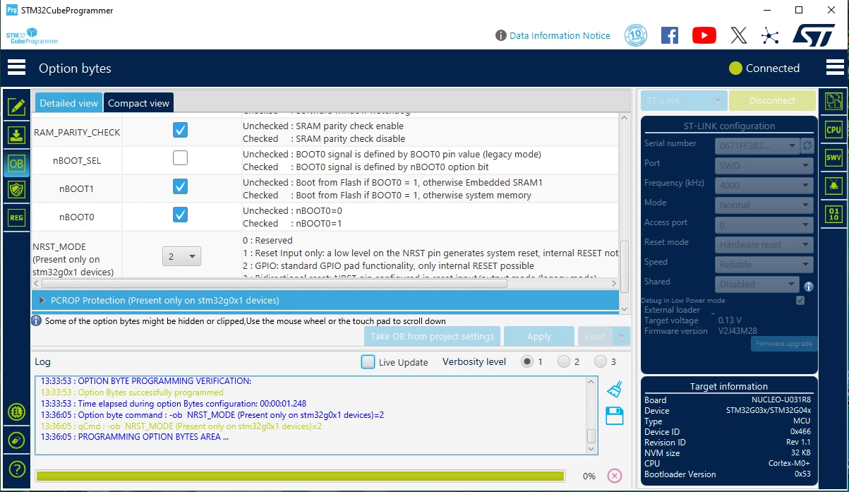

Unable to change NRST_MODE on stm32g031j6m6
I am working on using NRST pin in stm32g031j6m6 as GPIO, but it fails every time. I've changed many option bytes and even options present only on stm32g0x1 have workwd on my chip, except of NRST_MODE. If i want to change this option to 2 (gpio mode) and try to apply, the progress bar stays at 0% endlessly until i quit the STM32CubeProgrammer. I didn't have any problems with communication between nucleo and stm32g031. I tried to program my chip with st links built in nucleo u031 and f303, everytime without success. What else can i try?

Mar 9, 2026 6:04 PM UTC
Unable to duplicate here on STM32CubeProgrammer v2.21.0.
What version of STM32CubeProgrammer are you using? If not the latest, try that.
Is this a separate issue? Please clarify.
If USB connections are flaky in general, it's probably a computer problem. Try eliminating hubs or using a different cable and port.

Hello there @elektronik_BP ,
Thank you for bringing this to our attention.
I have reproduced this on v2.22 and I have reported this to the dedicated team. (internal ticket number:0060237)
For now, you can switch to v2.21 as it works there and I'll let you know ASAP when this is fixed.
PS: Ticket number: 0060237 is an internal tracking number and is not accessible or usable by customers.

Jun 19, 2026 12:30 PM UTC
unfortunately there has been no new release of STM32CubeProgrammer yet, but it appears the issue is due to the naming of the Option Byte. In v2.21 it was called `NRST_MODE` and in v2.22 it is called `NRST_MODE (Present only on stm32g0x1 devices)`.
The STM32_Programmer_CLI program can not parse parameters with spaces though and neither does it accept quotes.
Unfortunately it also does not accept `NRST_MODE` anymore.
C:\Program Files\STMicroelectronics\STM32Cube\STM32CubeProgrammer\bin>STM32_Programmer_CLI.exe -c port=swd -ob NRST_MODE (Present only on stm32g0x1 devices)=3

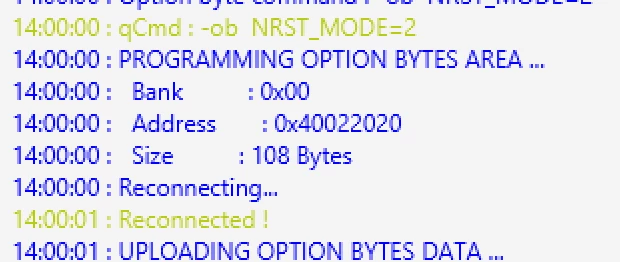

To summarize, there are multiple issues here:
  1. STM32_Programmer_CLI should accept quotes Option Bytes if they have additional descriptions in them.
  1. STM32_Programmer_CLI should have aliases for the actual name without the description.
  1. STM32CubeProgrammer should not hang if STM32_Programmer_CLI returns an error.

CRich.4
Aug 11, 2026 11:17 AM UTC
hi, i seem to have the same problem with an stm32g0b1re with STM32CubeProgrammer v2.23
the log window shows:
Option byte command : -ob  NRST_MODE (Present only on stm32g0x1 devices)=3
it seems like the command is not built correctly and erroneously includes the comment in parentheses
