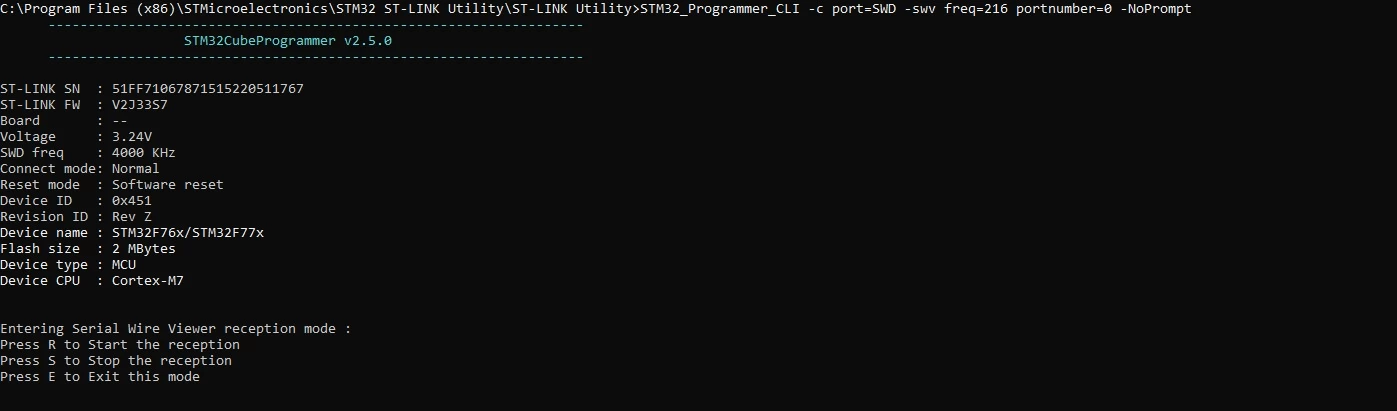

Hi there,
I've an issue when trying to automatize the SWV command with Jenkins. The issue is that when I run the command: STM32_Programmer_CLI -c port=SWD -swv freq=216 portnumber=0 it asks the user to press 'R' in order to start. Since Jenkins has no desktop or interface I cannot focus the window in order to press the button with a macro. I have tried with a tubed batch, python script and keyboard macro but nothings seems to work. So I guess my question is, has anybody done that? Is there any way I can pass the 'R' as a parameter in the command line?0693W000007ZqaKQAS.jpg

Hi @Rafael Castelló González​ ,
Thank you for raising this interesting point.
This issue is reported internally and will be fixed in future STM32CubeProgrammer version.
Houda

Hi @Houda GHABRI​ ,
Thanks for the reply. Any idea on how long will it take to release the new fixed version?
At the moment, I don’t have information to share as to when the next version will be released.
I will come back with the latest updates as soon as I have more information.
