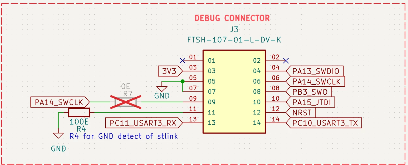

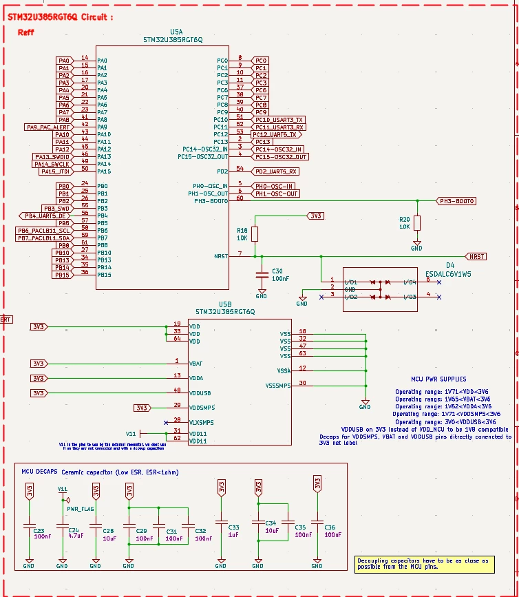

Schematics: MCU
Programming COnnector for ST Link

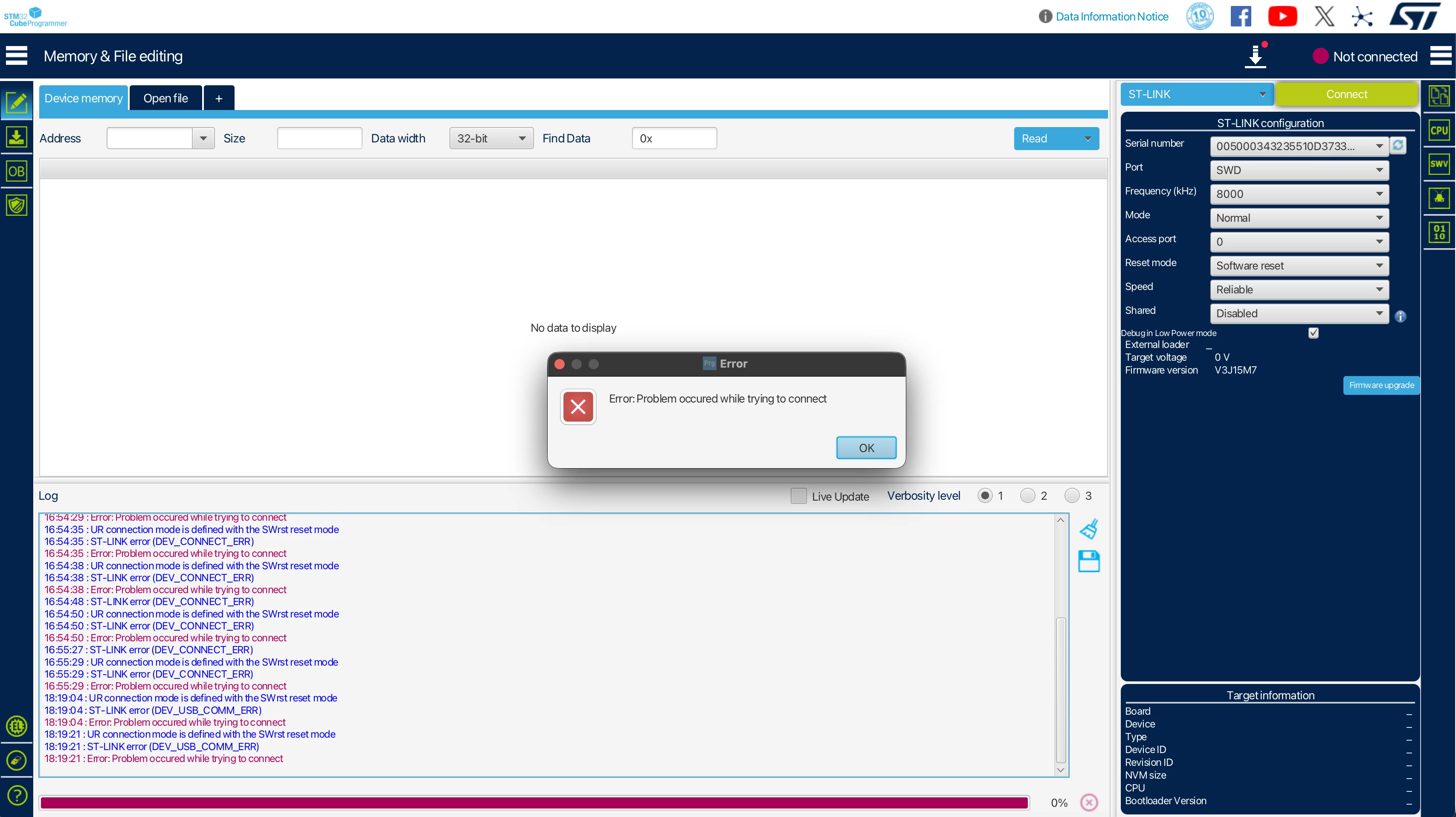

Observed Behavior
  1. Initially, the STM32 was not detected by STM32CubeProgrammer
    → Root cause: faulty USB cable + macOS security restrictions
  2. After switching to a proper data USB cable and Windows:
    → MCU detected and programmed successfully
    → Firmware runs (RGB LED turns green)
  3. After reinstalling the ESD protection diode (ESDALC6V1W5):
    → MCU can still be programmed once successfully
  4. After first programming cycle:
    • MCU becomes undetectable by ST-Link
    • RGB LED no longer functions
    • No signal observed on LED data line
    • Reprogramming is no longer possible

Error screenshot
Key Suspicion
I suspect that ESDALC6V1W5 may be causing:
  • Signal distortion on SWD lines (SWDIO / SWCLK)
  • Back-powering or clamping issues
  • Possible damage or latch-up after first execution
The issue consistently appears only after the diode is reinstalled.
Questions
  1. Can the ESDALC6V1W5 interfere with SWD programming/debugging lines?
  2. Is it possible that the diode is:
    • Injecting current into MCU pins?
    • Causing latch-up or permanent damage?
  3. Are there recommended ESD protection strategies specifically for SWD lines on STM32U3 devices?

Shirley.Ye
Jul 21, 2026 10:27 AM UTC
you mentioned External protection: ESDALC6V1W5 on data lines, but from the schematic, seems only the NRST have the ESDALC6V1W5, what data lines do you connected the ESDALC6V1W5?
