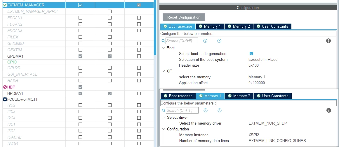

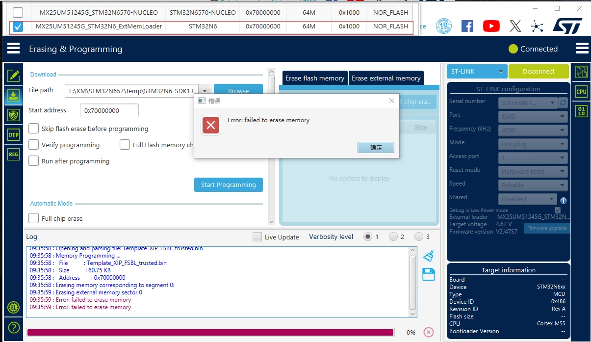

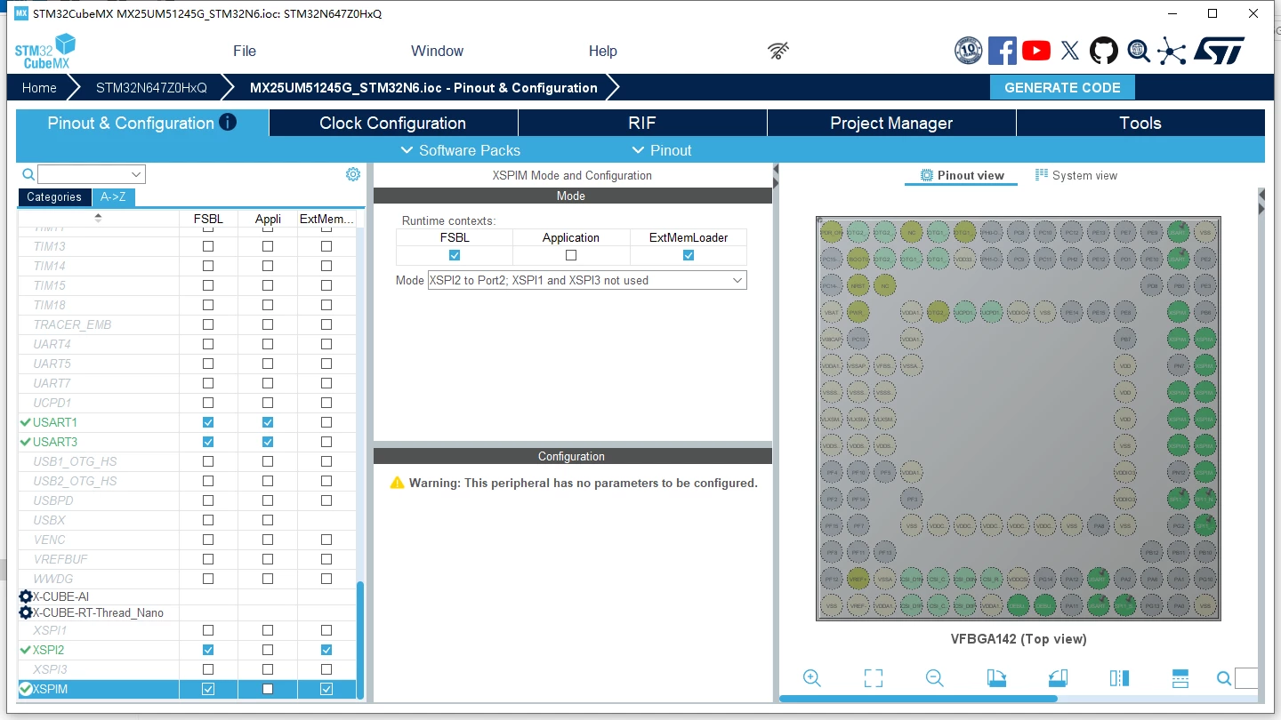

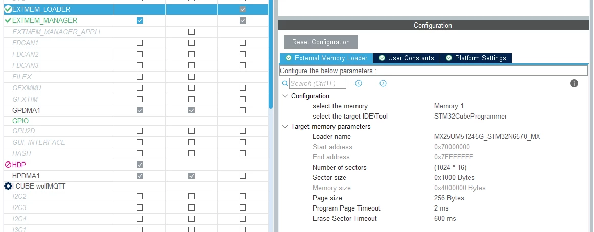

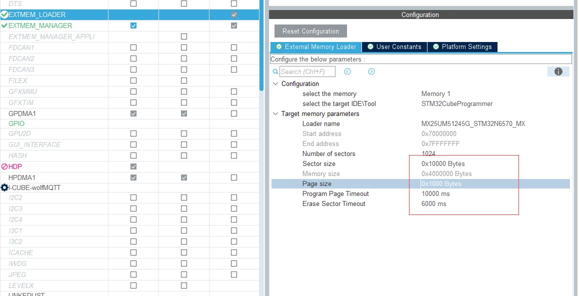

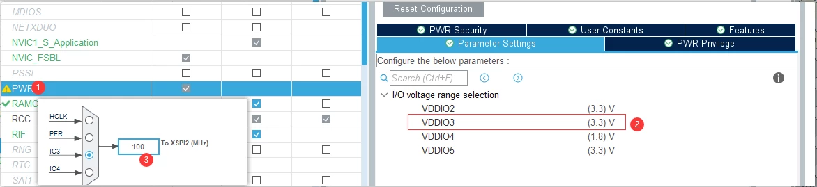

STM32N647Z0 failed to create the download file for mx25um51245 external flash
I want to create an MX25UM51245G. sldr, but it keeps failing with a prompt
Use the official MX25UM51245G_STM32N6570-NUCLEO.stldr to confirm that the board can be downloaded successfully
Please check the MX configuration that I generated for MX25UM51245G_STM32N6_ ExtMemLoader. stldr

Hello ​@liuqw ,
Can you try setting the optimization to “Optimize for size (-Os)” when building the external loader.

liuqwAuthor
Jul 24, 2026 2:54 AM UTC
Trying to adjust to the overall size, but still receiving an error message

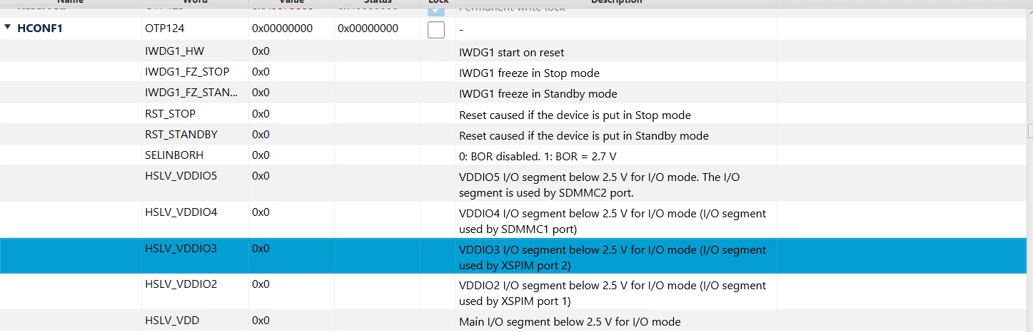

liuqwAuthor
Jul 27, 2026 2:40 AM UTC

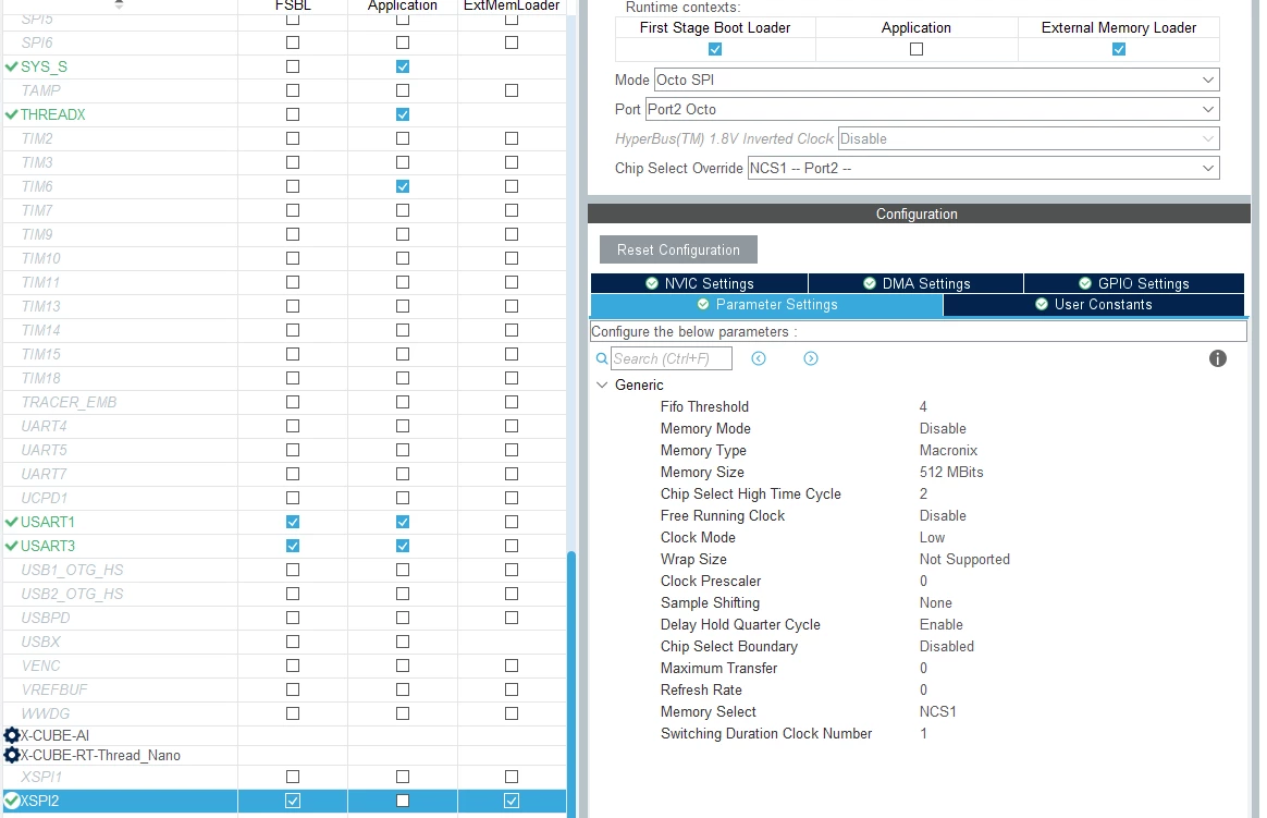

Thank you, according to the method you mentioned, I have resolved the use of STM32N645 for MX25UM51245.
I am actually using MX25LM51245. On the hardware side, the VDDIO3 of N6 has been modified to supply 3.3V, and the power supply of MX25LM51245 has been modified to 3.3V. On the cubeMX software side, in order to modify the voltage of VDDIO3 of PWR to 3.3V, cubeIDE has been optimized for size (- Os) The use of MX25LM51245 on the board has failed. Do I need to make any other modifications? For example, Prg's OTP124?
