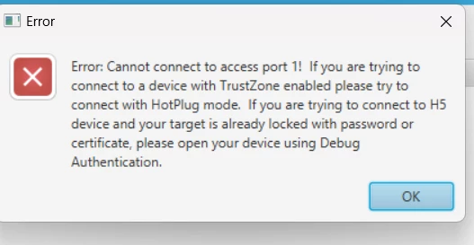

STM32H573I-DK: Cannot connect to access port 1
Iam working o STM32H573I-DK Board when am trying to access board am getting trustzone issue.
I tried with Debug Authentication also but am unable to access board.
Find the attached description.

Hello Hitesh,
is it the first time you are using the board? Dis you perform any operation with it? Did you try to close the device before or other things?
You can try to connect in "hot plug" mode and try to change the port number access.
If you perform a debug authentication what is the message returned?
Thank you

I'm using STM32H563ZIT6 controller and facing the same issue as above while trying to connect from STM32CubeProgrammer.
Just Powered up the board and trying to connect in normal mode through programming pins (SWDIO, SWCLK), I have verified the connections and I'm able to connect in Hot_plug mode and able to flash the code.

Voltage : 3.30V
Error: Cannot connect to access port 1!
If you are trying to connect to a device with TrustZone enabled please try to connect with HotPlug mode.
If you are trying to connect to H5 device and your target is already locked with password or certificate, please open your device using Debug Authentication.

I ran into this exact issue/error in my system, in which I use an embedded STM32. On my PCB, I included a pull-down resistor and toggle switch to set BOOT0 low (GND) or high (3V3) in case I needed to set it low or high. I mistakenly set BOOT0 high without realizing, and I encountered this exact error when trying to flash. When I switched BOOT0 back to low, my program flashed and ran exactly as I expected.
