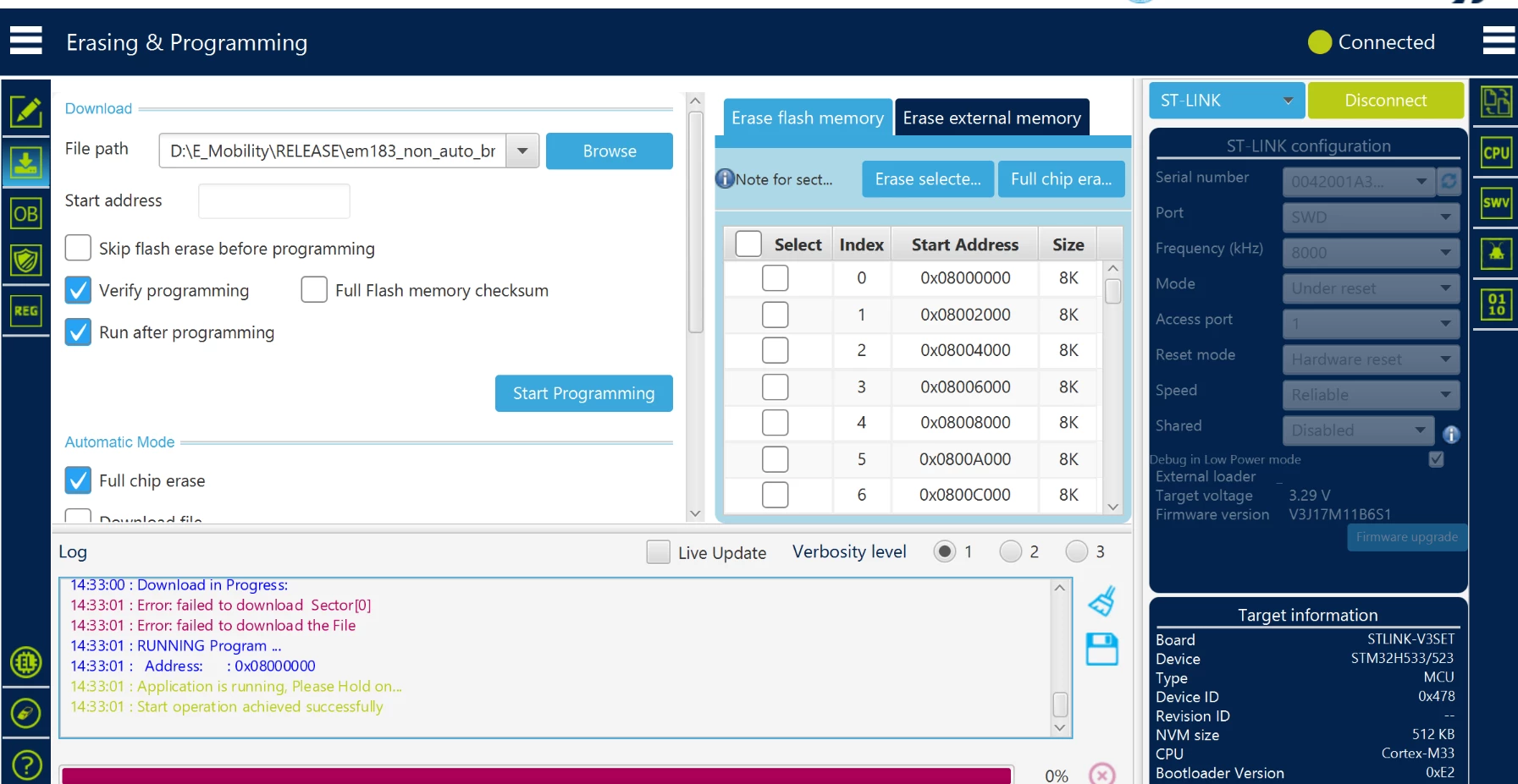

Jul 27, 2026 9:14 AM UTC
Dear Team,
The issue is reproducible even when the target voltage is detected correctly. I also verified the behavior using STM32CubeProgrammer, where the target voltage is displayed properly, confirming that the voltage is not the root cause of the issue.
Please find the screenshot below for your reference.
​@Aziz BRIGUI, Once more observation, When I program the device using the USB Type-C interface (on the Nucleo evaluation board used for testing), the flashing completes successfully. However, the issue is consistently reproducible when programming through the ST-LINK interface. Please provide a solution for this issue
