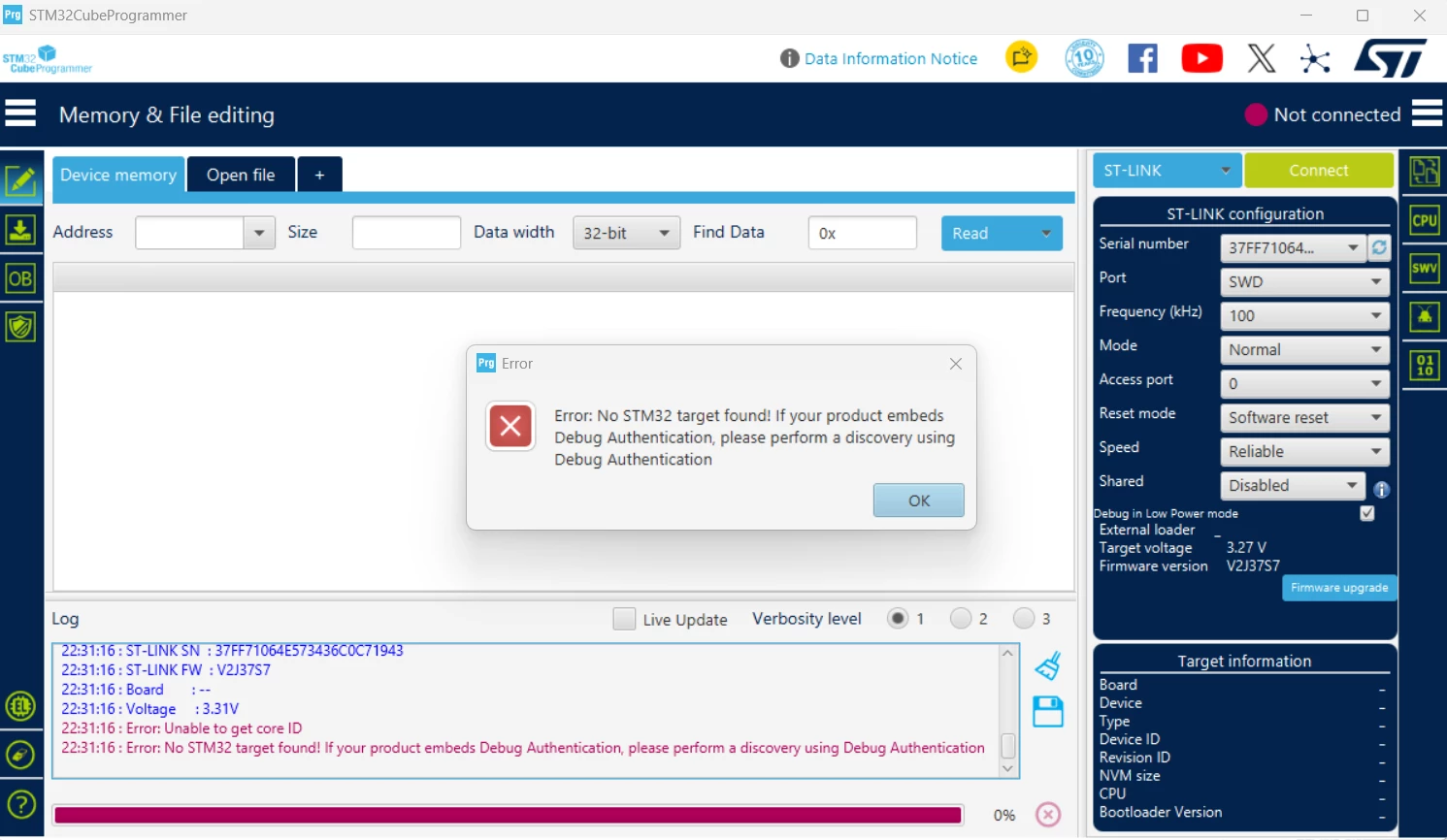

CubeProgrammer
Windows detects the ST-LINK correctly. Device Manager shows STM32 STLink.
CubeProgrammer also detects the ST-LINK and reports:
  • Port: SWD
  • Target voltage: ~3.27–3.31 V
  • ST-LINK firmware: V2J37S7
However, when I try to connect, I get:
Error: Unable to get core ID
Error: No STM32 target found!
If your product embeds Debug Authentication,
please perform a discovery using Debug Authentication
The Target Information section remains empty.
Troubleshooting already performed
I have tried:
  1. SWD frequency 4000 kHz
  2. SWD frequency reduced to 100 kHz
  3. Normal + Software reset
  4. Under Reset + Hardware reset
  5. Connected ST-LINK RESET → board NRST
  6. Verified SWDIO → PA13
  7. Verified SWCLK → PA14
  8. Verified GND and 3.3 V connections
  9. Tried with and without the Black Pill USB connected
The result remains:
The ST-LINK itself is detected correctly, and target voltage is visible, but the STM32F401CCU6 Core ID cannot be read.

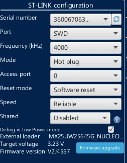

Well accidently i just have a F401 black pill connected with a st-link V2 (stick  or maybe “clone “); working fine.
Set Programmer to : software reset, connect normal or hot plug.

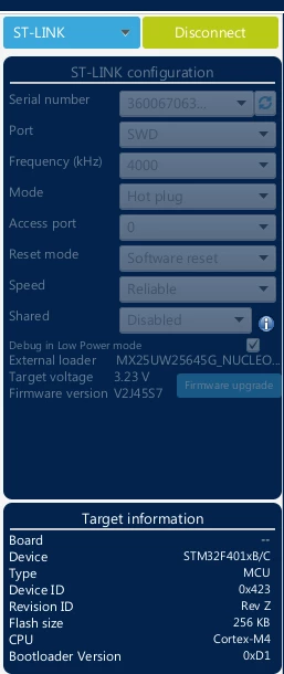

To check whether the MCU itself was working, I tested the USB bootloader. I held BOOT0, pressed and released RESET, and then released BOOT0. This made the STM32 enter its factory bootloader mode instead of running the normal application. Windows detected STM32 Bootloader, and STM32CubeProgrammer was able to connect through USB and read the MCU successfully. This confirmed that the MCU was alive.
The actual issue was the physical SWDIO connection. After properly soldering the SWDIO connection, the ST-LINK immediately connected and CubeProgrammer successfully detected the MCU.
So in my case, the problem was poor/intermittent SWDIO contact, not a damaged MCU or faulty ST-LINK clone.
