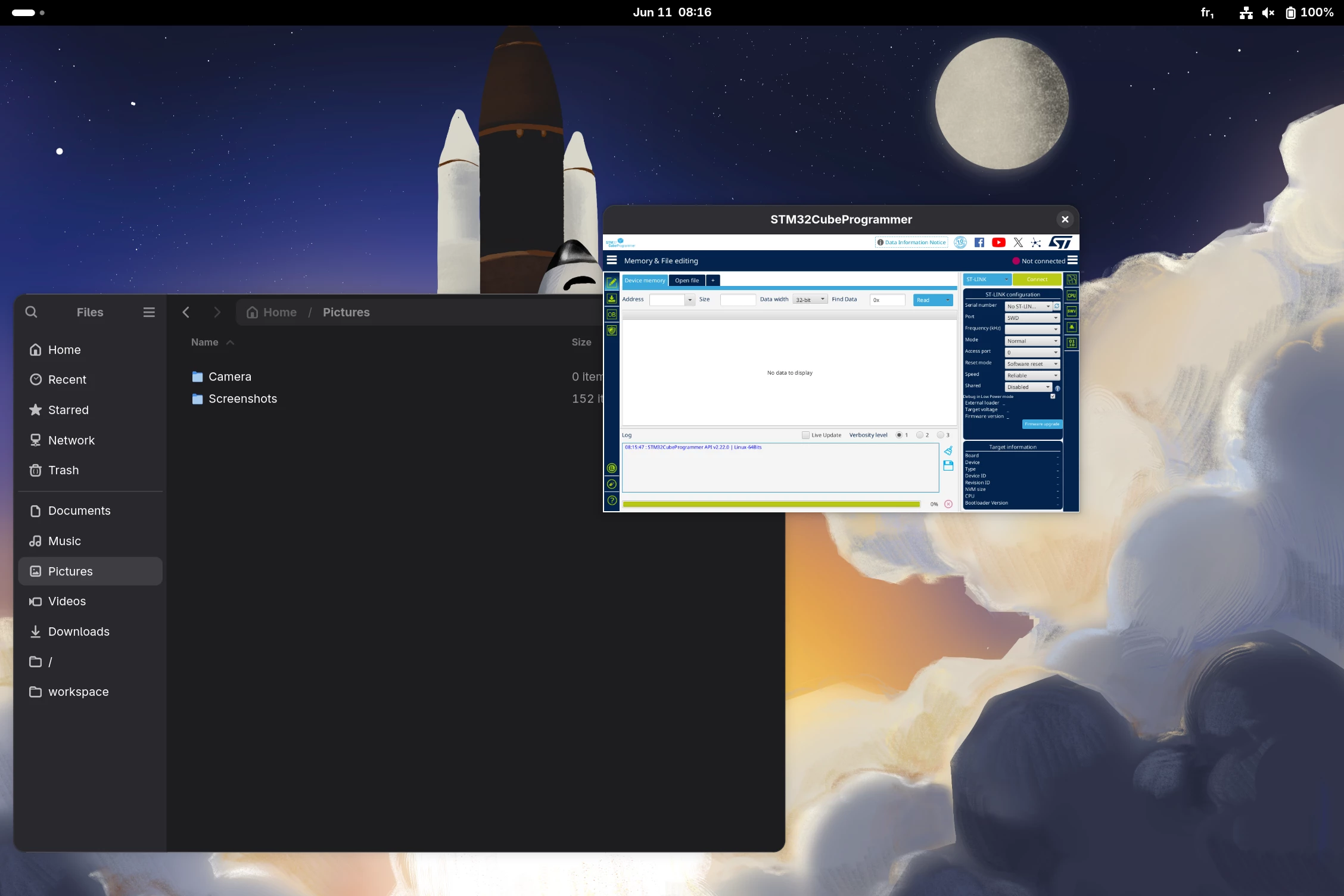

As shown in the picture above, on Fedora 43, the CubeProgrammer application is not matching the OS scaling and there are no options to configure it like in CubeMX. CubeProgrammer is the latest version (v2.22.0), installed today.
My computer is a laptop with a 2256x1504 screen and OS-level scaling is set to 133%. All other applications behave as expected, I only ever have issues with ST’s applications.
This issue has been reported multiple times in the past on different linux distributions. I have tried all suggested fixes in those posts, none worked. Links to other issues that had no solutions:

Managed to get this working on Fedora 43, needed to do some extra stuff to get OpenJDK 17 and OpenJFX 11 however.
OpenJFX has to be downloaded from this link: https://gluonhq.com/products/javafx/ and you have to include the archived versions to access the version 11. I copied the content into “/usr/lib/jvm/openfx-11/” so all java packages are in the same folder.
Then, OpenJDK needs the temurin repo, which can be added with the following commands:
sudo dnf install adoptium-temurin-java-repository
sudo fedora-third-party enable
sudo dnf install temurin-17-jdk
Then the modified bash launch script looks something like this:
#!/bin/bash
CUBE="$HOME/STMicroelectronics/STM32Cube/STM32CubeProgrammer/bin"
GDK_BACKEND=x11 \
LD_LIBRARY_PATH="$CUBE/../lib:$LD_LIBRARY_PATH" \
/usr/lib/jvm/java-17-temurin-jdk/bin/java \
-Djdk.gtk.version=3 \
-Dglass.gtk.uiScale=2 \
--module-path /usr/lib/jvm/openjfx-11/lib/ \
--add-modules javafx.controls,javafx.fxml,javafx.web,javafx.swing \
-jar "$CUBE/STM32CubeProgrammerLauncher"
This will work for Fedora 43 but I hope an official fix gets implemented in CubeProgrammer directly as this is a lot of work for something that should not be on the user’s side to fix. JavaFX 11 has been deprecated for a while now, having to rely on it is far from ideal. Same for Java 17, it’s not available by default on Fedora 43 because newer versions should be used instead.

SOLVED WORKAROUND — Ubuntu/Wayland/HiDPI
I found a working workaround for this issue using system OpenJDK 17 + OpenJFX 11 and forcing JavaFX to use X11 with -Dglass.gtk.uiScale=2.
Tested successfully on Ubuntu with a 3072×1728 / 192 DPI display.
I attached the complete step-by-step solution and launcher script for other Linux users.

Hello ​@Emile BV & ​@ict ,
This issue has been fixed in STM32CubeProgrammer v2.24.0. You can download it via this link.
Emile BVAuthor
Nov 18, 2026 2:31 PM UTC
No it’s not fixed.
Emile BVAuthor
Nov 18, 2026 2:40 PM UTC
As a bonus, the previously working workaround does not appear to work with the new v2.24.0 version.
