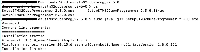

I have installed Java:
Successfully installed STM32CubeProgrammer:

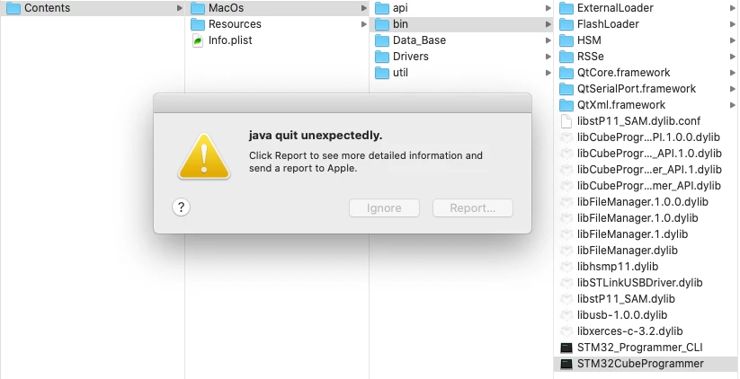

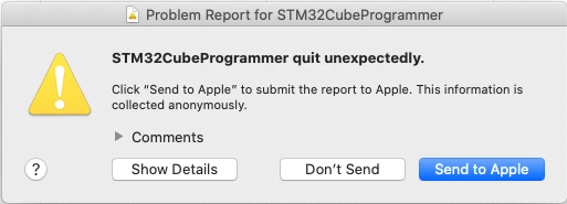

0693W000003QOEuQAO.pngIf i launch in finder CubeProgrammer quits
If i launch in terminal java quits
I currently have STM32CubeIDE, STM32CubeMX, STM32CubeMonitor and STM32CubeMonitorRF all installed and working correctly.
Does anybody have any suggestions for a solution? I know this issue has been reported by a number of other community members using older software versions.

I'm having same issue - installed various versions of JDK - currently on 8.0_231 - and no matter which version of java I use or how I launch SetupSTM32CubeProgrammer-2_5_0_macos (either via .app or command line) I get the following:
Last login: Thu Oct 1 12:12:17 on ttys003
/Users/chucka/Downloads/en.stm32cubeprog_v2-5-0/SetupSTM32CubeProgrammer-2.5.0.app/Contents/MacOs/SetupSTM32CubeProgrammer-2_5_0_macos ; exit;
chucka@MacBook-Air-5 ~ % /Users/chucka/Downloads/en.stm32cubeprog_v2-5-0/SetupSTM32CubeProgrammer-2.5.0.app/Contents/MacOs/SetupSTM32CubeProgrammer-2_5_0_macos ; exit;
Error: Unable to access jarfile ../../../SetupSTM32CubeProgrammer-2.5.0.exe
[Process completed]
Any suggestions on how to get this thing installed?

Hello @LBeau.1​
The root cause of this issue may be conflicts between Java versions, so please, if you have many java versions installed try to uninstall all except 1.8.0_26 and then re-install CubeProgrammer.
