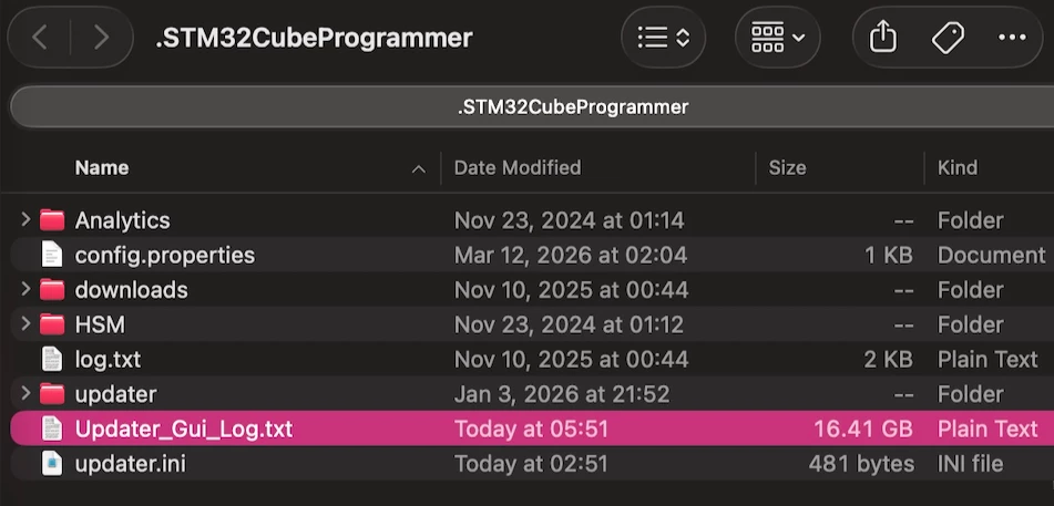

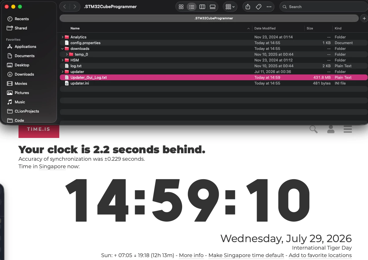

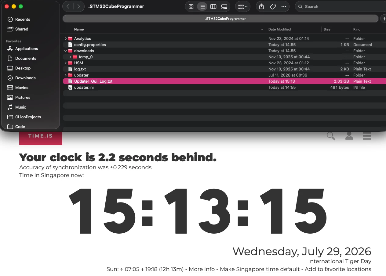

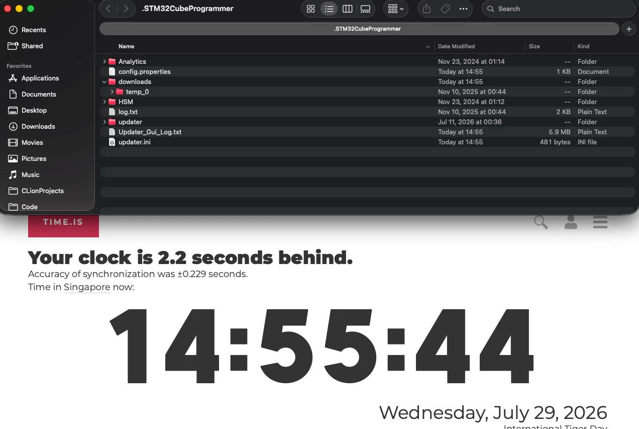

I noticed that simply leaving STM32CubeProgrammer running causes the file ~/.STM32CubeProgrammer/Updater_Gui_Log.txt
to grow continuously at a very high rate. The file increases by hundreds of megabytes within minutes and can easily reach multiple gigabytes if STM32CubeProgrammer is left open. In my case, I have already experienced the log file completely filling my macOS system disk overnight, which caused abnormal system behavior due to the disk running out of free space.

In my test, the log file increases with around 1.7MB/s or 106MB/min, which can cause swerve stress in storage.
