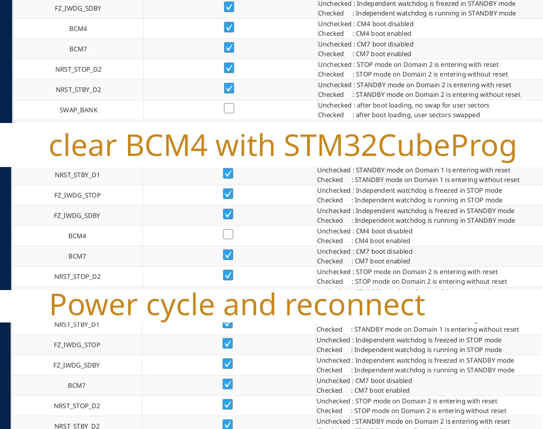

STM32CubeProg stm32h7xx Option Bytes User Configuration disappears if disabled by firmware
If on a STM32H747 the Cortex-M4 (BCM4 or BOOT_M4 Bit) is disabled by software, it is impossible to reactivate it with the STM32CubeProg v2.18.0 because the checkbox disappears in the user interface. But this happens only if you do a power cycle and reconnect to the target.

It happens with STM32CubeProg too:

After applying the the new option byte configuration go to the device memory and read the content of the registers
FLASH_OPTSR_CUR and FLASH_OPTSR_PRG:
FLASH_OPTSR_CUR located at the address 0x5200201C
FLASH_OPTSR_PRG located at the address 0x52002020
For example this is a screenshot of my FLASH_OPTSR_CUR reading:
8 means the CM4 is disabled. C means CM4 is enabled.
If you find that the reading of these registers corresponds to what you set in the option bytes, this means the option byte were physically correctly set and there is something went wrong in CubeProgrammer.

So it's a GUI issue not related to the hardware.
Internal ticket 204208 has been opened for analysis. This ticket is not accessible by the community users.

Any update on this?  I have the exact same issue.  I unchecked BCM4 in STM32CubeProgrammer for STM32H745, and then after reboot, the checkbox isn't even there to check it again.
Also, it is not just GUI because the Cube Programmer CLI says the BCM4 register isn't available now.

Hello @dariis
Issue fixed in the latest STM32CubeProgrammer release available under this link: STM32CubeProg | Software - STMicroelectronics.
