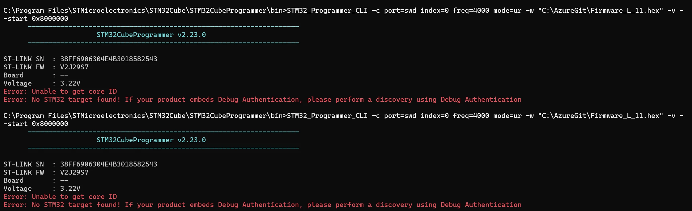

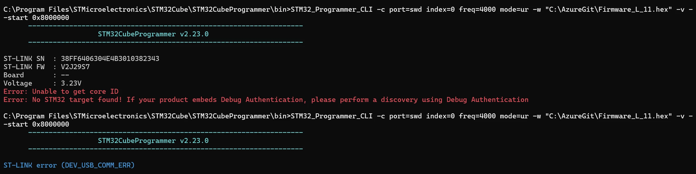

I am encountering an issue when connecting an ST‑Link with no target attached. On the first connection attempt it reports “No STM32 target found.” If I attempt to connect a second time, the adapter returns the error “ST‑LINK error (DEV_USB_COMM_ERR).” The only reliable recovery I have found is to unplug and replug the USB device:
ST-LINK with DEV_USB_COMM_ERR issue
When I use a different ST‑Link from the same batch (B 2022 48) with the same firmware, it behaves as expected and reports “No STM32 target found” until a target is present:

Environment and reproduction steps:
- Software: STM32CubeProgrammer CLI and GUI v2.23.0 (issue also reproducible with v2.22.0)
- Commands (basically any -c):
STM32_Programmer_CLI -c port=swd index=0 freq=4000 mode=ur -w "<Firmware path>" -v --start 0x8000000
- OS: Windows 11
- USB: Direct connection to PC
- Cable: Same behavior with a Tag‑Connect or no target cable attached
- ST‑Link firmware: V2J29S7 (factory firmware)
- Version: ST-LINK V2

I ended up updating the firmware. I confirm that it solves the issue.

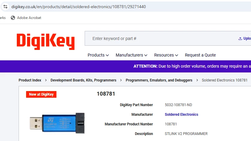

Andrew Neil
Jul 7, 2026 2:56 PM UTC
Is it a genuine ST-Link ?
Jul 7, 2026 3:03 PM UTC
Hello Andrew, yes we buy and use exclusively ST-Link from Digikey (official Distributor as you probably know).
DigiKey Part Number
497-10484-ND
Andrew Neil
Jul 7, 2026 3:41 PM UTC
Doesn’t stop them selling clones:
