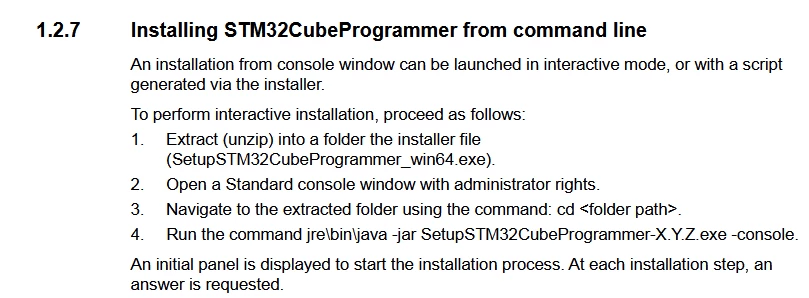

Silent Install
Now I have no idea what any of what you described have to do with silent install. I think you might be confuse with section “1.2.7 Installing STM32CubeProgrammer from command line” from the manual

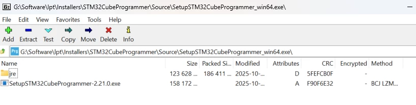

The first step is to unzip the installer “SetupSTM32CubeProgrammer_win64.exe” (the one you used to install with the GUI). I do it with 7zip. It will be much clearer then:
So as you can see the “SetupSTM32CubeProgrammer_win64” is just a zip archive with the installer and a jre included to actually install it.
From there you can extract the archive, open a CMD in the folder and execute:
.\jre\bin\java -jar .\SetupSTM32CubeProgrammer-2.22.0.exe -console
