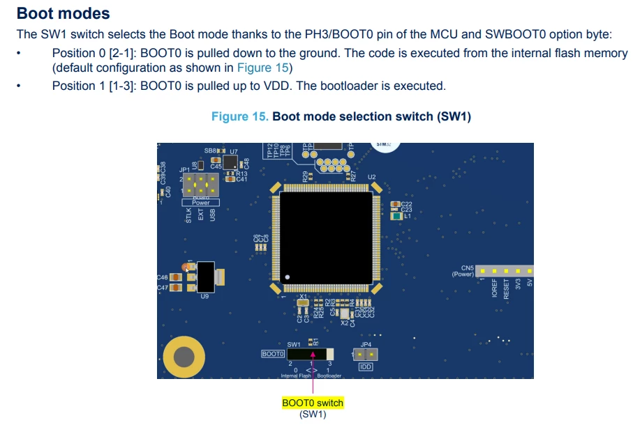

Kouthair
Dec 9, 2025 3:23 PM UTC
Hello Wesleywong,
Could you please set the BOOT0 switch to Position 1 and try reconnecting using STM32CubeProgrammer?
Kouthair.
Dec 9, 2025 5:29 PM UTC
Hi @Kouthair ,
I tried your suggestion and got the same result.
I tried both position 1 and 0.
If the mode is HOTPLUG, I got "Error: Uploading Option Bytes bank: 0 failed" and "Error: Initializing the Option Bytes failed".
If the mode is UR, power down or normal, I got error "DEV_TARGET_NOT_HALTED".
I tried keep pressing reset button and then click "connect" in cube programmer. also got error "DEV_TARGET_NOT_HALTED" after releasing the reset button.
