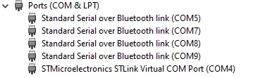

I see a FAIL.txt file in the mass storage that says "The interface firmware FAILED to reset/halt the target MCU".
LD1 and LD3 are red.
I cannot even load the simple programs like Blink LED using any IDE.
The on-board F401RE chip is quite hot. Dropping a bin file doesn't help either. Nothing is running on it.
It was working perfectly 2 days ago and I don't know why it doesn't work anymore.
Any help or suggestions will be appreciated. I included some photos for reference.

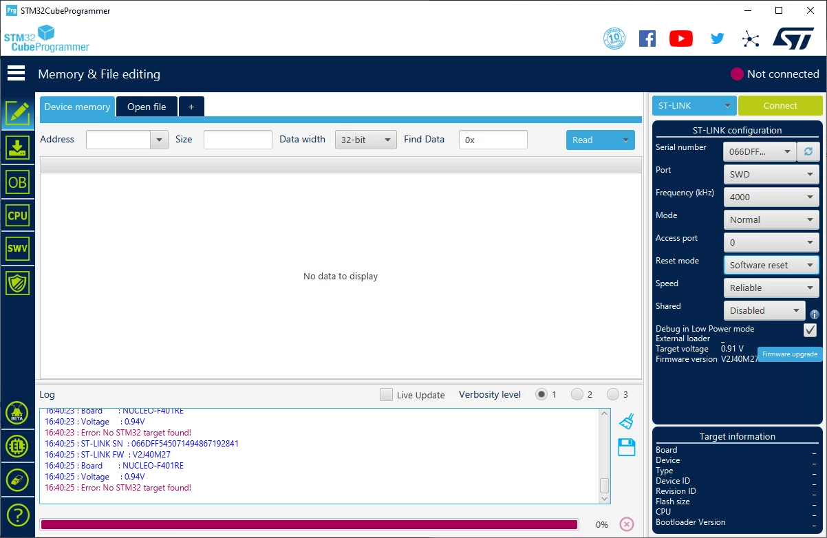

P.S. I tried STMCubeProgrammer but that doesn't connect either.
Error:
16:40:25 : ST-LINK SN : 066DFF545071494867192841
16:40:25 : ST-LINK FW : V2J40M27
16:40:25 : Board    : NUCLEO-F401RE
16:40:25 : Voltage   : 0.94V
16:40:25 : Error: No STM32 target found!
I have all the latest software installed.

The voltage is wrong, perhaps check level with a multi-meter or scope.
If its burn your finger hot, something is seriously wrong.
Likely shorted something out, or placed on a conductive surface
