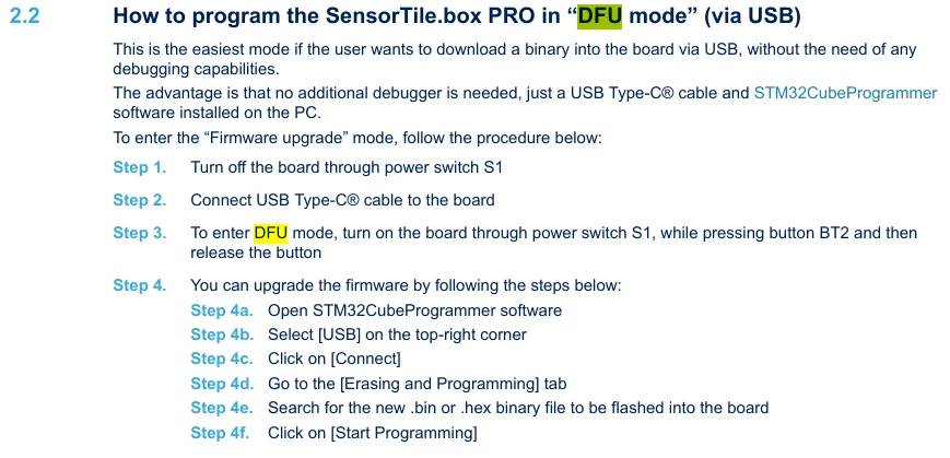

I am trying to do the firmware upgrade via USB using STM32CubeProgrammer and putting the MKBOXPRO in DFU mode, but the program doesn't detect any DFU port and gives the error : "Establishing connection with device failed"
If anyone can help with this i appreciate.
I followed this instructions:

What Host system?
Does the system detect the unit?
eg, in Windows, does it appear in Device Manager?

Windows
It doesn't apear on the device manager.

Then, clearly, nothing on the system is going to be able to see it.
It's a basic connectivity issue - start with checking cables, etc.
Some suggestions here:
https://community.st.com/t5/stm32-mcus/how-to-solve-debugger-connection-issues/tac-p/698105/highlight/true#M956
