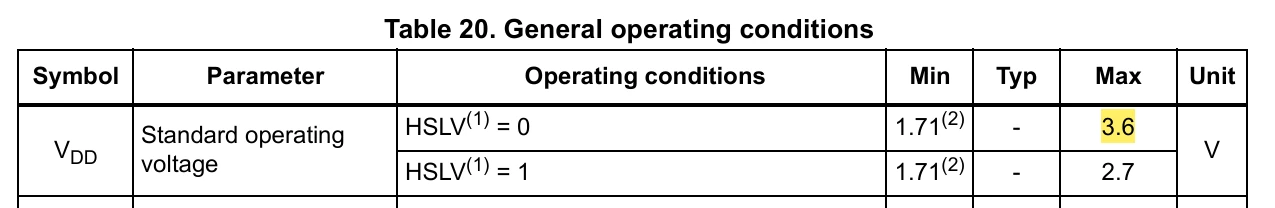

> 11:47:40:879 : Voltage : 2.39V
Is that intentionally low?
Nov 25, 2025 1:36 PM UTC
I've just checked with a DMM and the LDO is outputting 3.8V, which is also on the mcu VDD pins.  I'm not sure why it is low on the STLINK reading!
Nov 25, 2025 1:39 PM UTC
Well there's (one of) your problem(s). 3.8 V is above the operation conditions for the chip. Typically, the operating voltage is 3.3 V max.
The STLINK-V3MINIE is likely reporting the voltage correctly, so you should reconcile that as well.
Showing schematic may help.
Nov 25, 2025 1:42 PM UTC
Thanks, I'll ask the engineer who designed the board for feedback on what might be going on.
