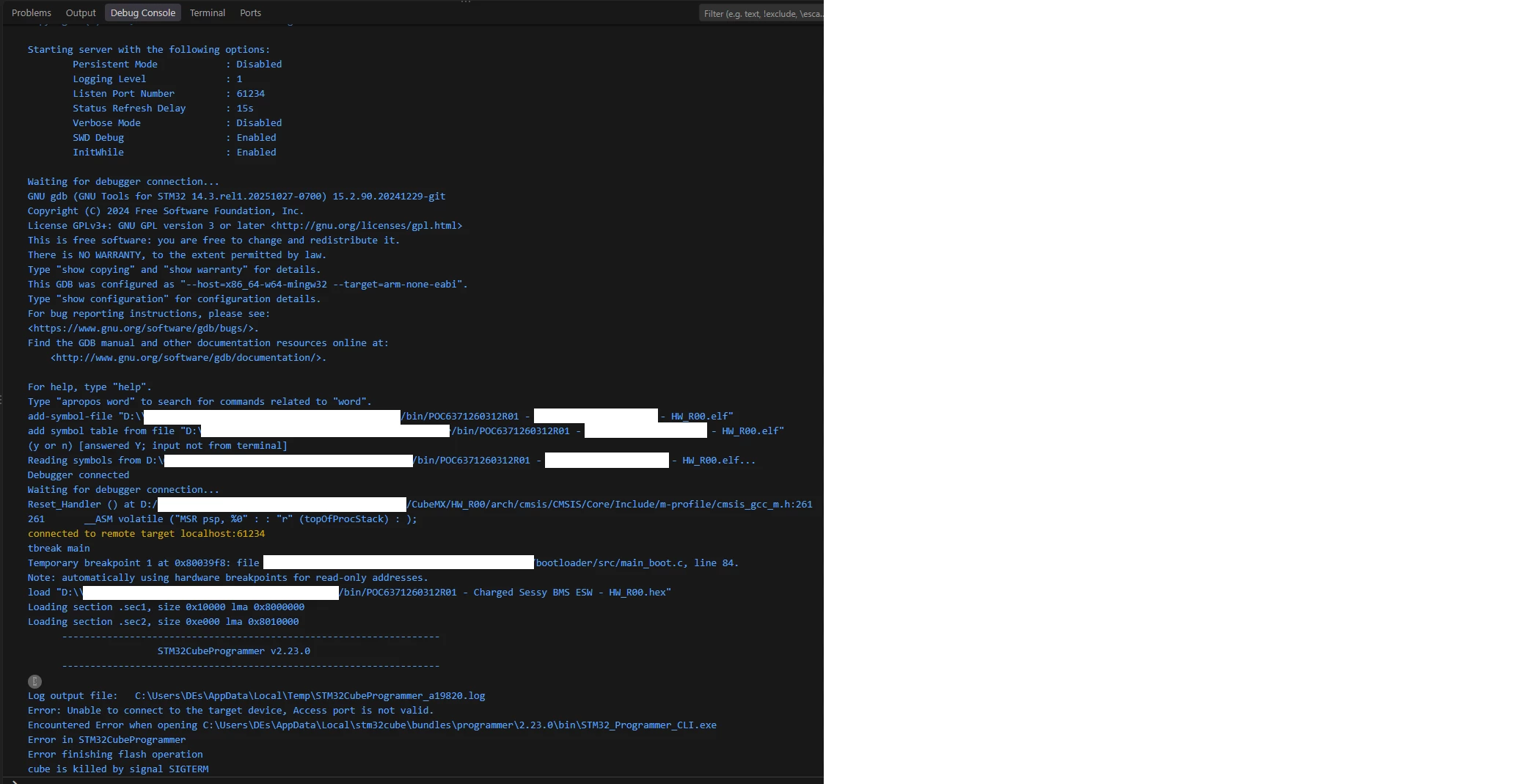

I’m having an issue when flashing / debugging with the STLINK-V3SET + ISO (V3J17M11B6S1). From VSCode I get the error Error: Unable to connect to the target device, Access port is not valid. This issue does not appear when using STLINK-V3MINI (V3J17M10).
I updated STM32CubeProgrammer vscode bundle to 2.23.0 and then code upload / debug worked once and now I’m getting the Access port is not valid error again. I tried setting the “serverApID” in the launch.json to force the correct Access port however I can’t get this to work.
Is this a known issue?

STLINK-V3SET V3J17M11B6S1
STMicroelectronics ST-LINK GDB server. Version 7.13.0
Copyright (c) 2026, STMicroelectronics. All rights reserved.
Starting server with the following options:
Persistent Mode : Disabled
Logging Level : 1
Listen Port Number : 61234
Status Refresh Delay : 15s
Verbose Mode : Disabled
SWD Debug : Enabled
InitWhile : Enabled
Waiting for debugger connection...
GNU gdb (GNU Tools for STM32 14.3.rel1.20251027-0700) 15.2.90.20241229-git
Copyright (C) 2024 Free Software Foundation, Inc.
License GPLv3+: GNU GPL version 3 or later <http://gnu.org/licenses/gpl.html>
This is free software: you are free to change and redistribute it.
There is NO WARRANTY, to the extent permitted by law.
Type "show copying" and "show warranty" for details.
This GDB was configured as "--host=x86_64-w64-mingw32 --target=arm-none-eabi".
Type "show configuration" for configuration details.
For bug reporting instructions, please see:
<https://www.gnu.org/software/gdb/bugs/>.
Find the GDB manual and other documentation resources online at:
<http://www.gnu.org/software/gdb/documentation/>.
For help, type "help".
Type "apropos word" to search for commands related to "word".
add-symbol-file "D:/DEV/application/build/debug_GCC_NUCLEO-C562RE/NUCLEO_C562RE.elf"
add symbol table from file "D:/DEV/application/build/debug_GCC_NUCLEO-C562RE/NUCLEO_C562RE.elf"
(y or n) [answered Y; input not from terminal]
Reading symbols from D:/DEV/application/build/debug_GCC_NUCLEO-C562RE/NUCLEO_C562RE.elf...
Debugger connected
Reset_Handler () at D:/DEV/application/CubeMX/NUCLEO_C562RE/user_modifiable/Device/STM32C562RET6/startup_stm32c562xx.c:258
258 {
connected to remote target localhost:61234
tbreak main
Temporary breakpoint 1 at 0x8004298: file D:/DEV/application/application/src/main_app.c, line 122.
Note: automatically using hardware breakpoints for read-only addresses.
load "D:/DEV/application/build/debug_GCC_NUCLEO-C562RE/NUCLEO_C562RE.elf"
Loading section .vectors, size 0x188 lma 0x8000000
Loading section .text, size 0x21068 lma 0x8000190
Loading section .rodata, size 0x8048 lma 0x80211f8
Loading section .ARM, size 0x8 lma 0x8029240
Loading section .init_array, size 0x8 lma 0x8029248
Loading section .fini_array, size 0x8 lma 0x8029250
Loading section .copy.table, size 0xc lma 0x8029258
Loading section .zero.table, size 0xc lma 0x8029264
Loading section .data, size 0x3288 lma 0x8029270
STM32CubeProgrammer v2.22.0
Log output file: C:\Users\DEs\AppData\Local\Temp\STM32CubeProgrammer_a20172.log
Encountered Error when opening C:\Users\DEs\AppData\Local\stm32cube\bundles\programmer\2.22.0+st.1\bin\STM32_Programmer_CLI.exe
Error in STM32CubeProgrammer
Error finishing flash operation
cube is killed by signal SIGTERM

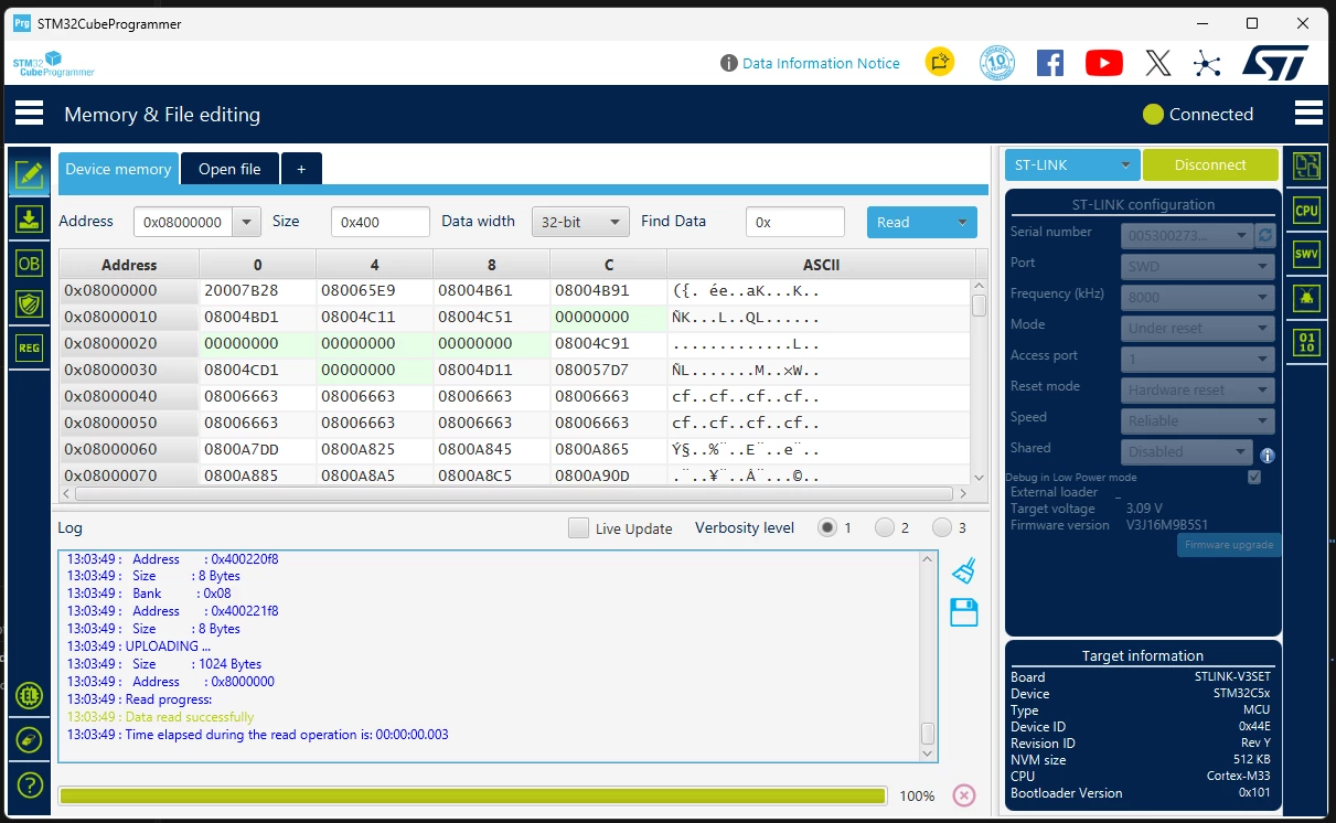

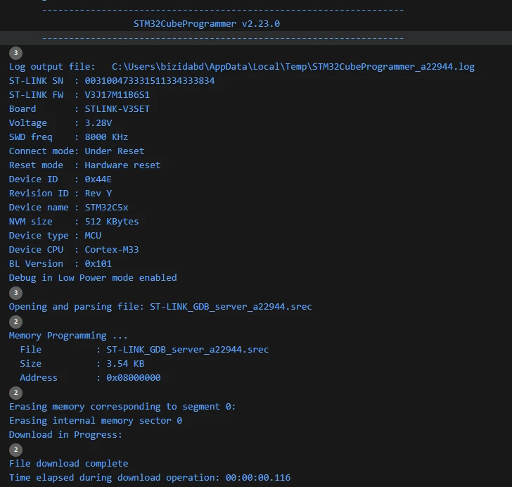

DEsAuthor
Hi ​@Kouthair,
Thanks for investigation the issue. I’m not in the office today however we have the B-STLINK-ISOL module stacked on top of the STLINK-V3SET.
Wiring issues seem very unlikely we use 1 to 1 cable that came with the STLINK-V3SET.
The test I did was connect
STLINK-V3MINIE to the DEBUG_IN port on the NUCLEO-C562RE then program + debug was working. The 2nd test I did was connect STLINK-V3SET + B-STLINK-ISOL tot the DEBUG_IN port of that same NUCLEO-C562RE board. Then i got that ‘Access port is not valid’ message.
My colleague did get the STLINK-V3SET + B-STLINK-ISOL program + debug working once with STM32CubeProgrammer v2.23.0 once. I believe a 2nd try resulted in the same ‘Access port is not valid’ message.
I never had issues with either board using the STM32CubeProgrammer GUI tool.
DEsAuthor
I just re-tried program and attach using STLINK-V3SET + B-STLINK-ISOL and it failed in vscode. Again the Access port is not valid message. Without touching the wiring I’m able to connect to it using STM32CubeProgrammer:
I updated firmware to V3J17M11B6S1 and get the same error message.
Again I don’t have this issue with STLINK-V3MINIE.
