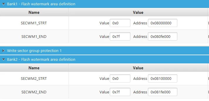

From STM32CubeProgrammer I wanted to change the SECWM1_End value and start address of Bank2 from 0x8100000 to 0x8040000 but it is giving me error.  Is there any possible way to change this configuration? And change the Bank2 swap address?

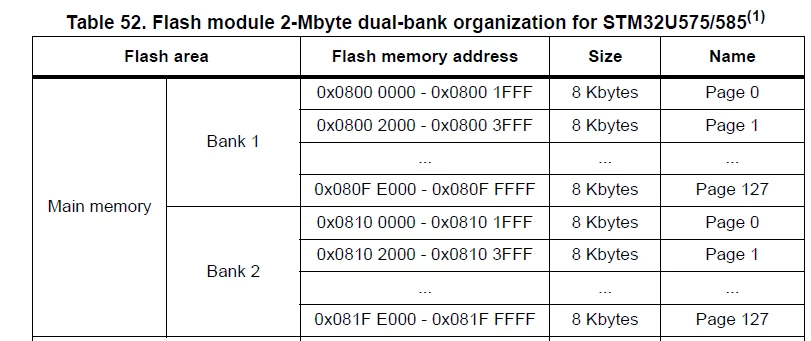

All right, so you have set the SWAP_BANK option bit in the user configuration. It modifies the address of each bank in the memory map.
Q : Is there any possible way to change this configuration? And change the Bank2 swap address?
A : Bank 2 base address is 0x08100000 for STM32u575/585 (what is your STM32 ?) You cannot declare the bank 2 with SECWM2_STRT & SECWM2_END in the bank 1 at the address 0x8040000. Here are the two flash area definition for a 2-Mbyte dual-bank on a STM32U5 :
