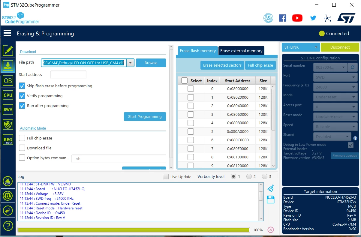

In cubeprogrammer unbale to add start address
I am working on NUCLEO-H7 board . Its dual core CM7 and CM4. When I Erase the full flash then I click into erase and programming option but I unable to add start address . The core M7 is get programming , but in Core M4 i unable to do programming because in start address block I unable to write . i am using latest version of cubeprogrammer.0693W00000QMvVYQA1.png

Use a .BIN file, not a .ELF

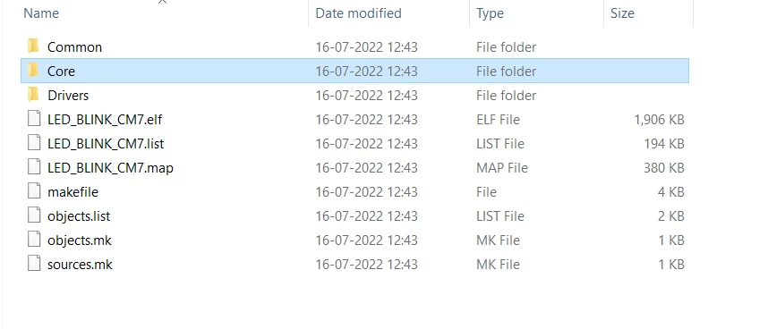

I am working on STM32CUBEIDE. In which folder I get the .bin file
Tesla DeLorean
Guru
Aug 4, 2022 7:11 AM UTC
Don't know, not my tools.
I'd imagine in similar place to .ELF if you've checked a "create .BIN" option, or you run objcopy

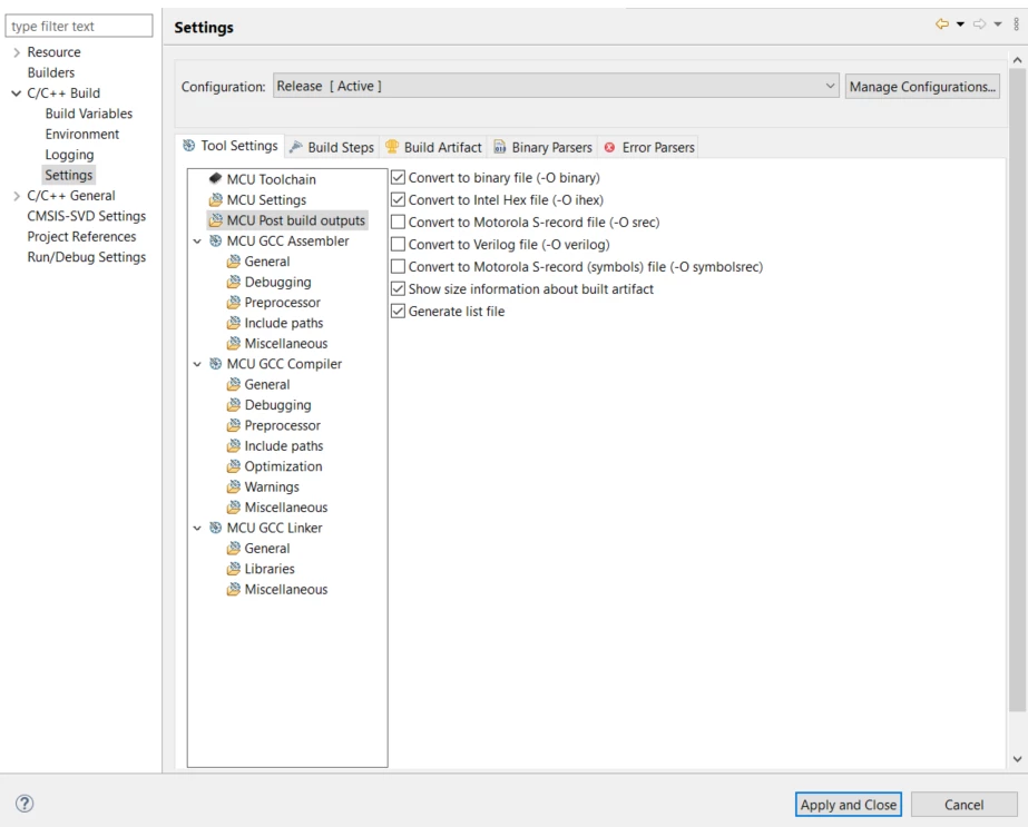

there are options to create bin and hex, please check the following picture:0693W00000QMx3WQAT.pngThey should be created in the same directory as the .elf file.
