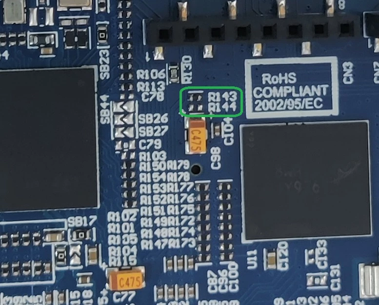

You could bridge the R144 pads with a wire, or wire some jumper or switch.
0693W00000aIiEbQAK.jpgYou should probably establish that the code you put on the board is where the problem is. As I understand the H750B-DK it uses the LDO, where as the H745I-DISCO uses the SMPS.

Piranha
Principal III
Mar 11, 2023 4:44 PM UTC
Connect mode: Under Reset
Reset mode : Hardware reset
Tesla DeLorean
Guru
Mar 11, 2023 6:42 PM UTC
That might work, but these H7's can be bricked quite easily to the point where serious intervention is required. Why there's not a jumper or switch perplexes me.
Sara BEN HADJ YAHYA
Mar 14, 2023 2:59 PM UTC
Hello @wsuwa.1​ ,
Thanks for your feedback,
Adding to what @Community member​ suggested, please check the following article How to unbrick an STM32H7 after setting the wrong power mode
Let me know if it helps!
