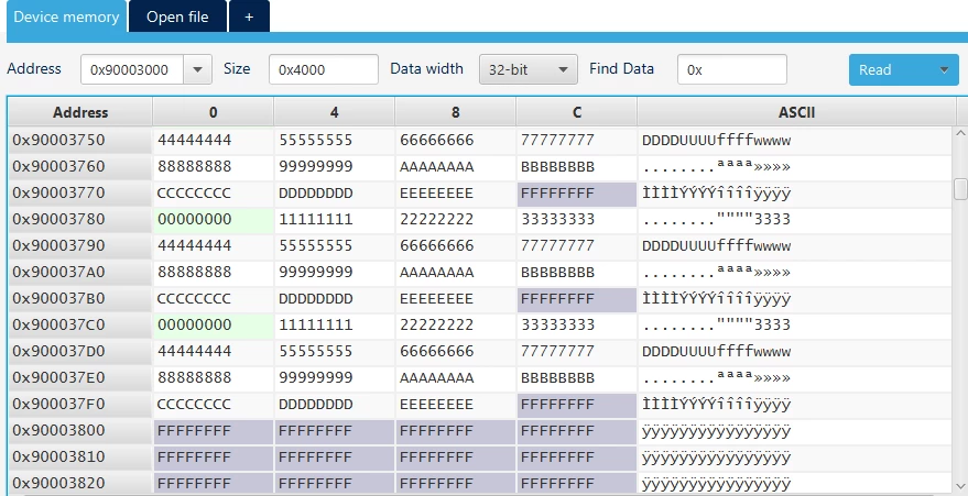

I have created an External Loader for my custom board with IS25LP064D connected to an STM32H730IB via OCTOSPI 1. I am able to successfully Read, Sector Erase and Mass Erase via Cube Programmer BUT Programming a Binary File into the Flash returns ERRO

0693W00000Kd6fIQAR.pngAn Interesting thing is that The file does get written till Address 0x900037FF but it fails afterwards as shown here:
I have tried using older versions of Cube Programmer ( 2.8.0 and 2.7.0) but still the same result.

If you erase and program repeatedly, does the "good" part (i.e. till 0x900037F0) always extend *precisely* to 0x900037F0? And, do you program in full page size (most commonly 256 bytes) chunks?

Hi Andreas, Thank you so much for your time. I have edited my original post. The final Address that is written is 0x900037FF(Not 0x900037F0) And Yes it always extends precisely to this Address.
The Write Memory Function that I have implemented uses the QUAD IN PAGE PROGRAM operation that programs 256 bytes per operation
Also please note that I wrote a program to write data from a Buffer big enough to Exceed 0x900037FF and it was successful. Its the External Loader when used with Cube Programmer (and Cube IDE) that is causing the issue.
