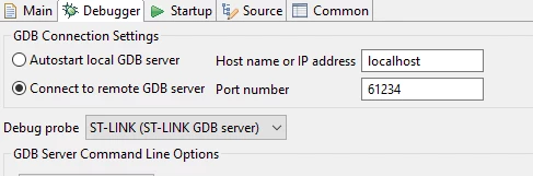

I have been using Nucleo 64 - STM32G474RET board for a while. But I suddenly started getting error while flashing the code, Not sure what is happening.. Please help
Failed to execute MI command:
target remote localhost:61234
Error message from debugger back end:
localhost:61234: Connection timed out.

Thank you. I checked, connectivity is okay. Board is getting flashed with STM32 Cube programmer ( invoked if select Autostart local GDB server) but not directly using from ST-LINK. 0693W00000QN6xxQAD.pngDoes this help in bringing more clarity to my issue?

MM..1
Aug 6, 2022 10:07 AM UTC
On your image is selected remote GDB , this result your system try connect to network debuger.
I use this for Cube on one PC and device with stlink 10km remote on next PC,
You maybe missunderstand image , for normal local debug you need upper choice Autostart.
PKale.1
PKale.1Author
Aug 6, 2022 6:50 PM UTC
Thank you. You awakened my sleeping brain.
