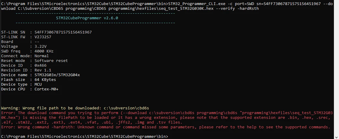

I have a strange issue with the STM32_Programmer_CLI.exe for cube programmer. It looks like that it handles the path different that I type it (see attached picture). Do I do something wrong?

try to put the file name within quotation marks.
-d "you file path/your file name"
and you should write "hardRst" instead of "hardRsth"

DLang.4
DLang.4Author
Jul 11, 2022 8:05 AM UTC
Yes, you are right. The problem is the space in the file path name. Replace the space with a underscore can also solve it. Thank you.
Andrew Neil
Jul 11, 2022 10:32 AM UTC
Another example of why spaces (and other "special" characters) are a Really Bad Idea in file (including folder) names.
This came up twice just last week; eg,
