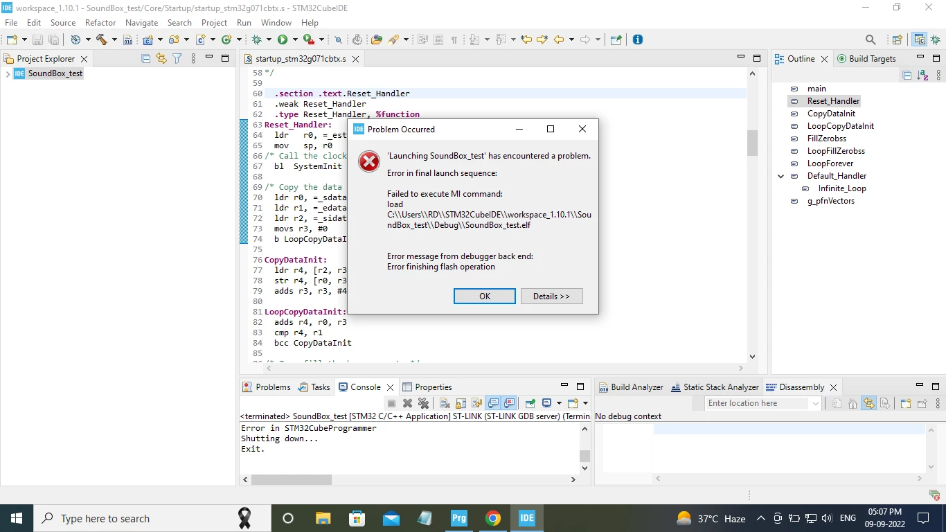

I am working on a STM 32 project in which at debugging step I found error thatis Error: The download command you trying to perform (--download) is missing the filePath to be loaded or it has a wrong extension Error in STM32CubeProgrammer Shutting dow

SGoel.2
SGoel.2Author
Sep 10, 2022 4:25 AM UTC
@Community member​ and @MM..1​ I have attached the image of the dialogue box showing the error. Again I have tried but the same error occurred. Please help me.0693W00000Sv3uSQAR.png
MM..1
Sep 10, 2022 9:25 AM UTC
Still hard to help, maybe incomplete debug configuration, maybe long project path or folder names with spaces or special chars usw.

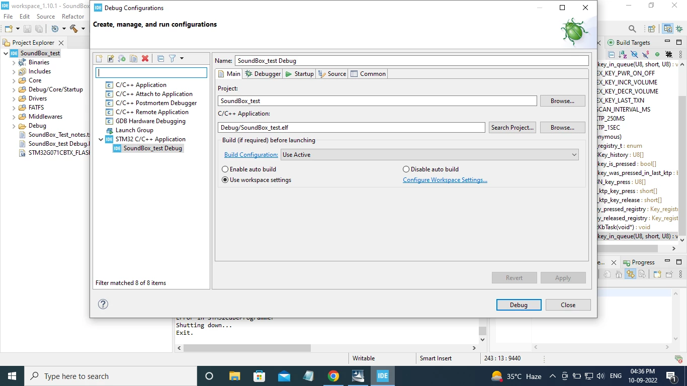

SGoel.2
SGoel.2Author
Sep 10, 2022 11:08 AM UTC
MM..1
Sep 10, 2022 2:55 PM UTC
Try load builded ELF externaly over stlink utility or proggrammer. If works, seems your IDE install is incomplete or corrupt, try reinstall.

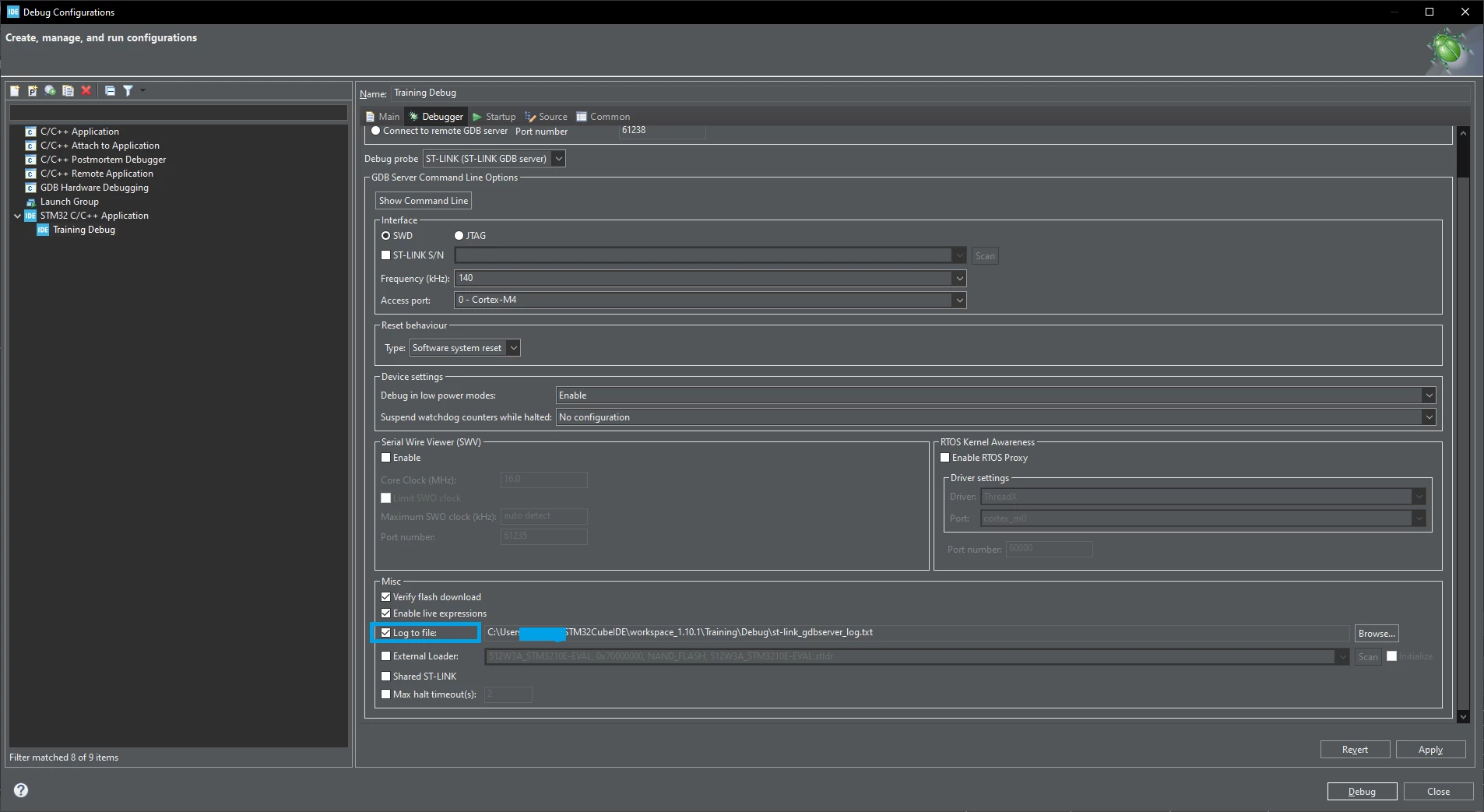

Semer CHERNI
Sep 13, 2022 3:36 PM UTC
Hello @SGoel.2​
As mentioned by @MM..1​  try to use CubeProgrammer to flash the binary. That result of this test could help to identify if it is a debugger issue or Programmer issue.
Also I want to ask you to post the rest of the debug configuration and try to generate and send post the debug log so I can analyze it.
You can do that by checking the box "log to file" under the debugger configuration window.
Kind regards,
Semer.
