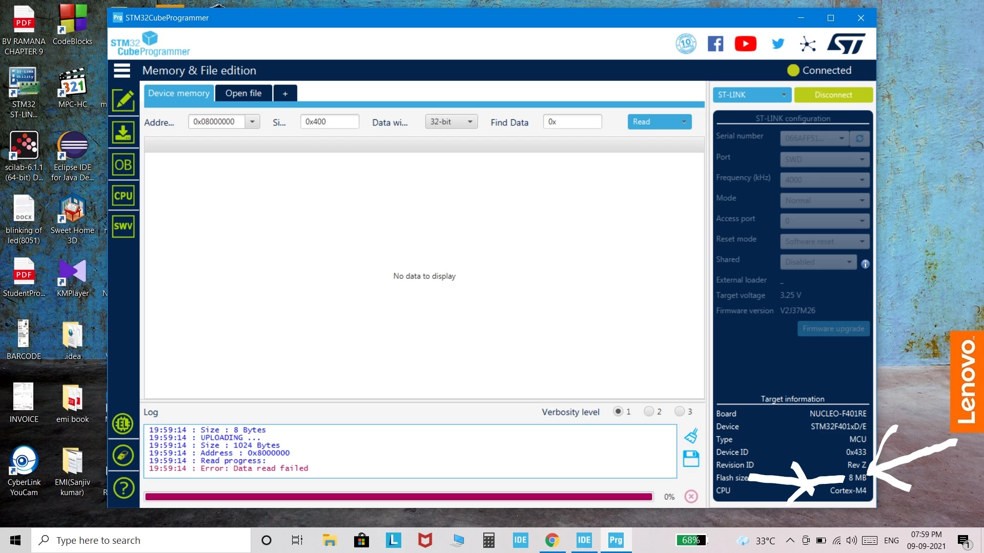

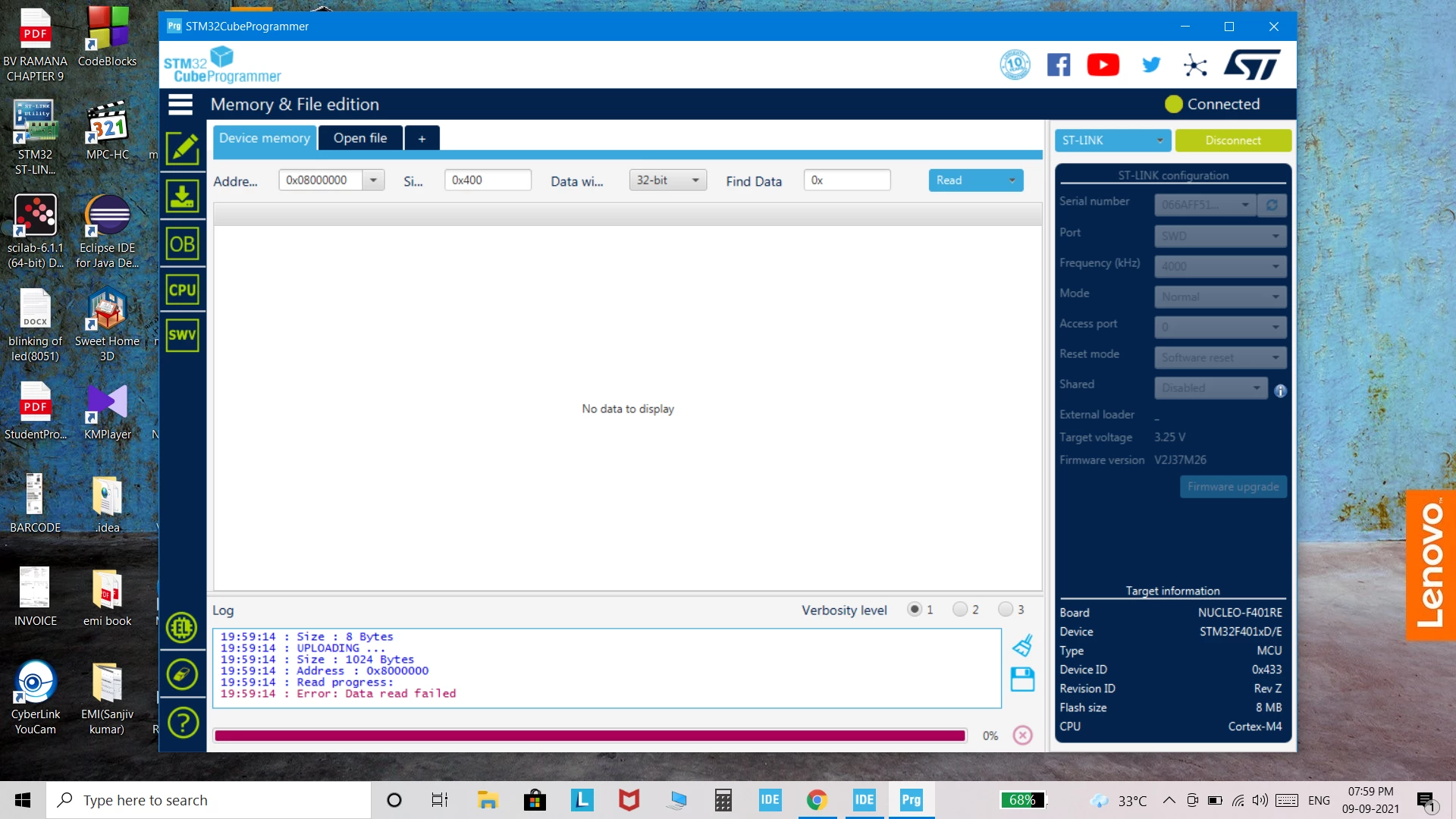

i am stuck with my stm32 nucleo 64. the problem is that it is not responding to any of the code and i am beginner so i dont know how to solve it. the problem
0693W00000DmkV3QAJ.jpgI did not set anything though. I did some researches and I try some things :
  • Change the Option Bytes in Target > Option Bytes > Read Out Protection. I don't know if it is relevant of the actual RDP state but when I open this tab, the RDP is on Level 1. When I set it to 0 and click on Apply, after few seconds an error is displayed saying Could not set Option bytes! Please reset the target and retry.
and also the flash size of stm32 nucleo is of 512kb but on stmcubeprogrammer it shows 8mb.
5 replies

> stm32 nucleo 64

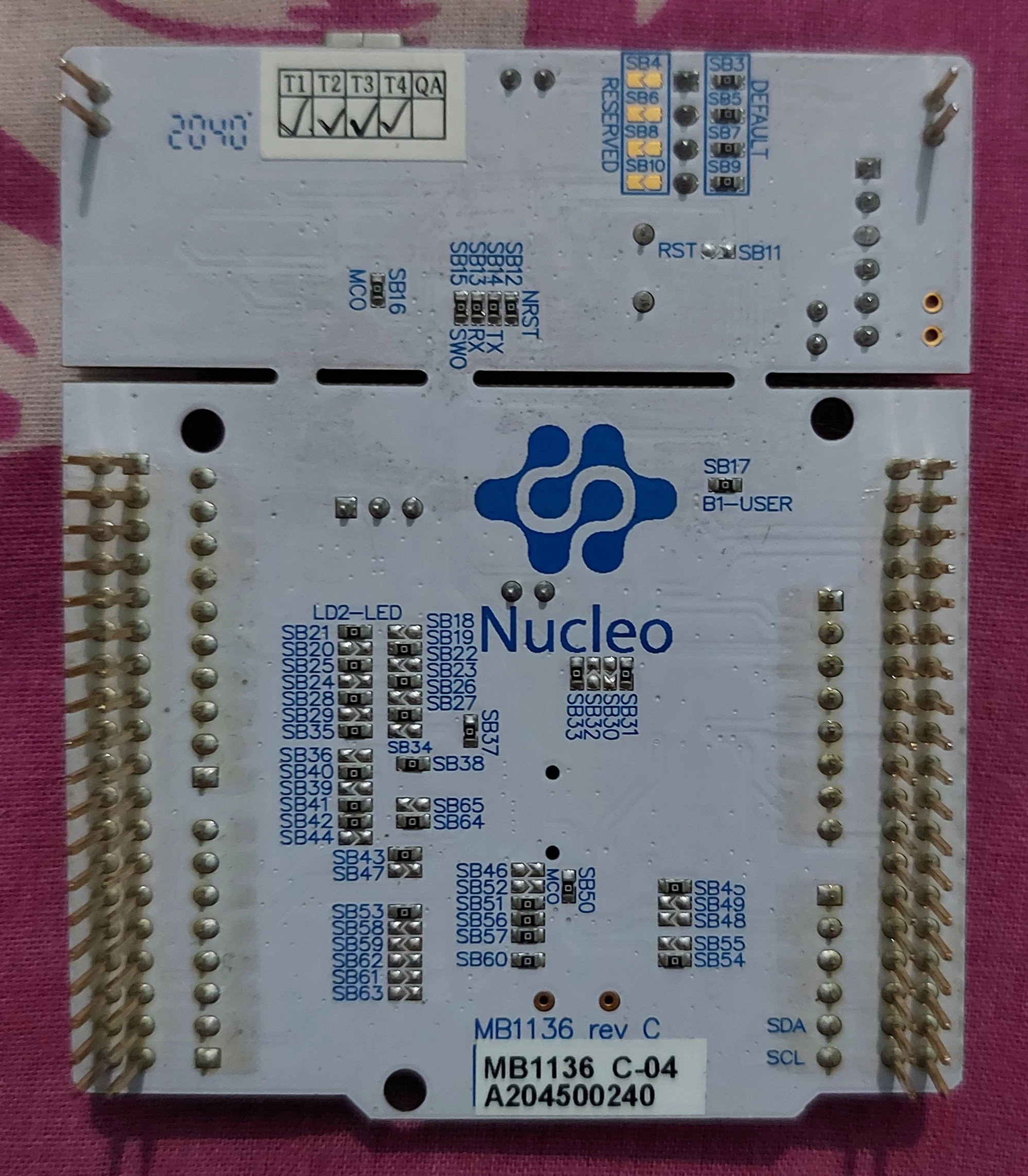

What board specifically, this one?
https://www.st.com/en/evaluation-tools/nucleo-f401re.html
If this is a clone/counterfeit/knock-off board, could be due to the hardware just being bad. If not, I would return it.
The size of the flash is in ROM memory. If the chip is reporting 8 MB consistently, clearly something is wrong.
You could also try ST-Link Utility.

i dont think it is a clone one .
Sep 12, 2021 2:10 PM UTC
Yep, seems like a genuine board.
I can't think of a reason it would behave this way other than faulty hardware.
