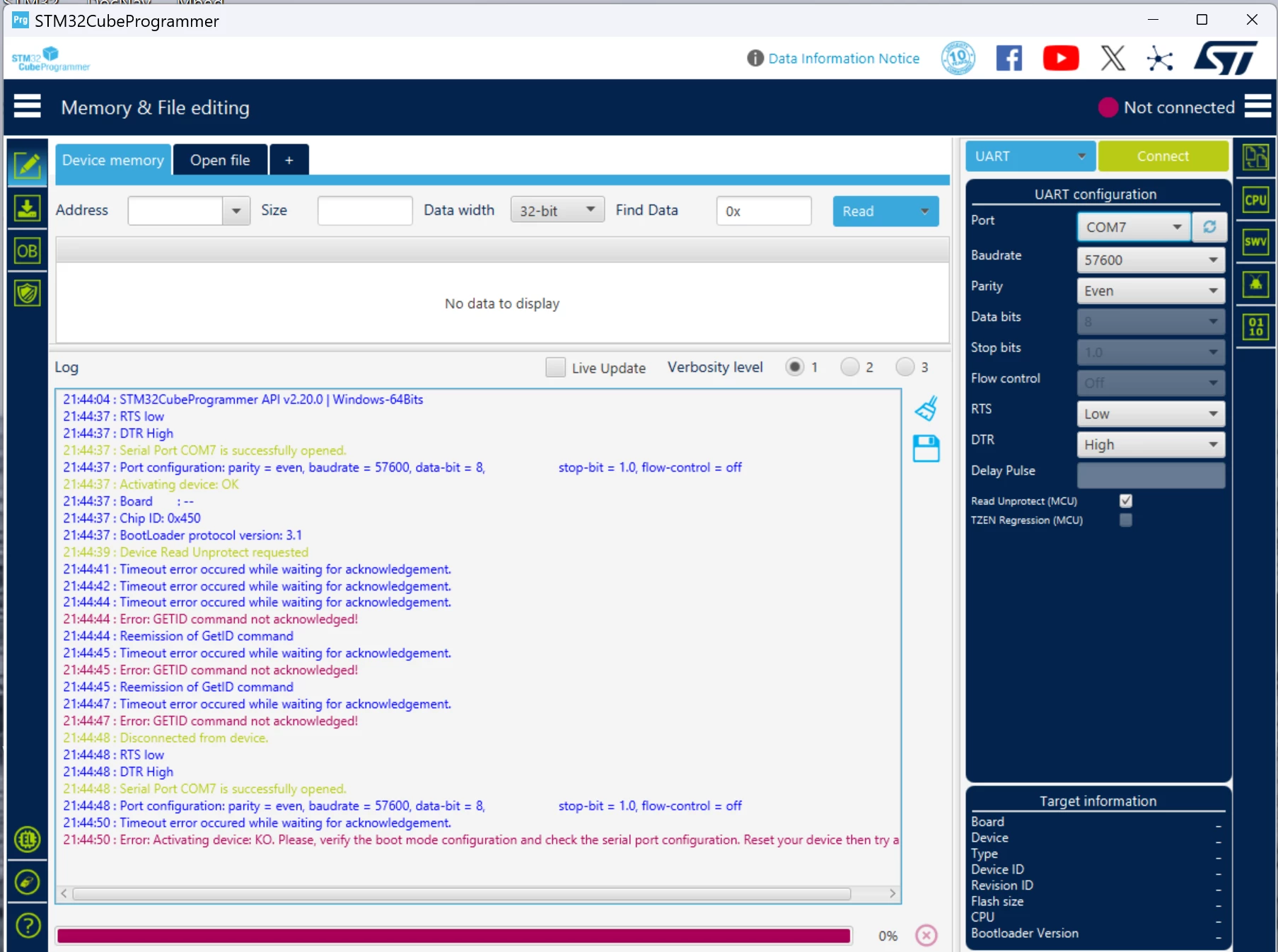

How to to download the program to the STM32H743VGT6 via the serial port?
Hello, I'm trying to download the program to the STM32H743VGT6 via the serial port. I keep getting the following error when using STM32CubeProgrammer. Do you have any solutions?屏幕截图 2025-11-03 214547.png

What USART interface and what GPIOs are you using?
Did you refer to the AN2606 section 56 STM32H74xxx/75xxx devices? not all the USARTs instances nor all the USART pins are available for the bootloader.
+ Boot pin = 1 before resetting the chip?

Hello, I used USART1 (PA9 and PA10). During connection, I held down both RST and BOOT0, then released RST first while keeping BOOT0 pressed. However, the aforementioned error consistently occurs.
Nov 3, 2025 2:25 PM UTC
What board is this?
Has this board ever worked?
Can you connect over SWD?
Nothing wrong with what you're doing, so the problem is elsewhere. Some possibilities:
  • Hardware issue (e.g. bad power supply, not powered, miswired)
  • Chip OB set up to ignore BOOT0.
  • Some other bootloader interface is active and takes over before USART1

Yes, my board has worked before. I've always used ST-Link (SWD) to program it.
Nov 3, 2025 2:51 PM UTC
Can you connect with SWD?
What did you do prior to it not working?

You get one-shot to connect at each reset.
Also perhaps watch for noise on other interfaces, say like a GPS/GNSS or MODEM, that squawks at startup that the H7 might recognize as an attempt to connect.
