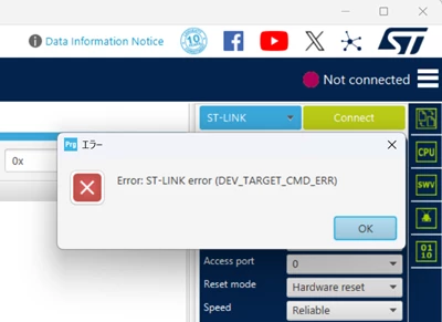

I'm trying to program a custom board equipped with an STM32WBA23CE.
I've tried wiring it from a Nucleo board (MB1801D), but the programming is failing.
CN3 pin5 -> Custom Board VDD
pin9 -> PA13
pin11 -> PA14
Even when I press Connect in CubeProgrammer, an error dialog appears.
It works normally when I disconnect the wiring to the custom board, so it doesn't seem to be an issue with the application or the Nucleo board.
The custom board does not have 32 kHz support.
Are there any resources or descriptions that might be helpful regarding this method?

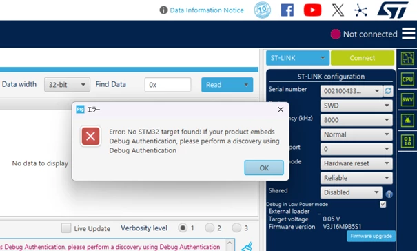

Removing the daughterboard fixed the problem.

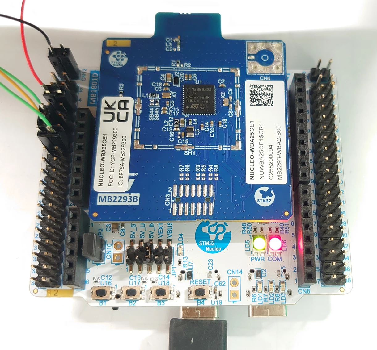

Aziz BRIGUI
Jun 23, 2026 9:30 AM UTC
Hello ​@gocchan,
I think power shouldn’t be going to the on Nucleo MCU. Try setting JP1 to 5V_VIN. Also try connecting GND between the custom board and the Nucleo board.
PS: If you’re not connecting the reset pin, HW reset isn’t triggered => it’s better to change the reset mode in this case.

The evaluation board I'm using is a NUCLEO-WBA25CE1. The IC mounted on the custom board is an STM32WBA23KE.
I tried changing JP1 from 5V_STLK to VIN, but I couldn't connect.
Changing the reset mode to Software Reset didn't solve the problem either.
GND is wired from CN12 to the custom board.
I also wired NRST (CN3 pin14) to the custom board, but that didn't solve the problem either.

I've attached a screenshot because the response was different when JP1 was set to VIN.
