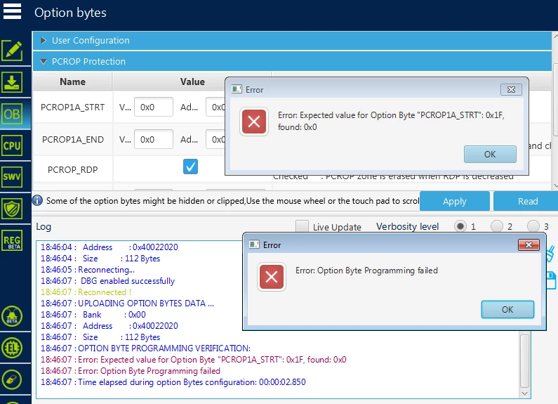

How to fix: Error: Mass erase operation failed. / verify flash protection
After evaluating/flashing the SBSFU examples on the NUCLEO-G071RB evalboard it's not possible to erase full flash anymore. I get the error below. How to set factory defaults that erasing is possible again?

Hello @Rena Z.​,
I'm seeing some PCROP and WRP are set. When a WRP or PCROP is set, mass erase is forbidden.
WRP or PCROP are enable when START_ADDRESS <= STOP_ADDRESS
 PCROP1A_STRT : 0x0 (0x8000000)
 PCROP1A_END : 0x0 (0x8000200)
WRP1A_STRT  : 0x0 (0x8000000)
WRP1A_END  : 0x0 (0x8000000)
First, disable PCROP and WRP protection, then proceed to the mass erase.
Let me know if it works.

Rena Z.
Rena Z.Author
Jan 18, 2023 4:44 PM UTC
seems that modifying PCROP1A_STRT does not work:
STM32_Programmer_CLI.exe -c port=SWD -ob PCROP1A_STRT=0x3F -ob displ

Error: Expected value for Option Byte "pcrop1a_strt": 0x3F, found: 0x0
Error: Option Byte Programming failed

Hello @Rena Z.​,
Can you try to read and change Option Bytes through CubeProgrammer?
I'll investigate Programmer_CLI.
Another test could be to read the Option bytes register in debug mode.

Here is an additional log where I have increased the verbosity level to 3:
 07:03:34:480 : r ap 0 @0x1FFF6FFE 0x00000004 bytes Data 0xFFFF00B2
 07:03:35:575 : r ap 0 @0x1FFF6FFE 0x00000004 bytes Data 0xFFFF00B2
 07:03:35:724 : Option byte command : -ob PCROP_RDP=1 PCROP1A_STRT=0xff

 07:03:42:156 : OPTION BYTE PROGRAMMING VERIFICATION:
 07:03:42:156 : Error: Expected value for Option Byte "PCROP1A_STRT": 0xFF, found: 0x0
 07:03:42:213 : Error: Option Byte Programming failed

Jan 18, 2023 5:49 PM UTC
0693W00000Y8ZH4QAN.pngsame issue with STM32CubeProgrammer.
how to read out in debug mode?
Simon.T
Jan 19, 2023 10:24 AM UTC
Hello @Rena Z.​ ,
To reset the PCROP1 you need also to perform a transition from RDP1 to RDP0.
So it means:
1-Check PCROP_RDP and put RDP=BB (level 1 reed protection)
2-Put RDP=AA (level 0, no protection)
3- Your PCROP registers have the default values.
Just be careful to not put the circuit as RDP level 2 otherwise the circuit will be blocked for ever.
Best regards,
Simon

Apr 29, 2024 2:32 PM UTC
I have a similar issue, can i have the script that put registers to default value ?
Mar 4, 2026 8:52 PM UTC
Hi, I generally had the same problem. I had changed the PCROP1_START value to be less than PCROP1_END, and my STM32G4 got stuck. I was not able to program almost any Option Bytes.
The solution was to simultaneously disable PCROP_RDP and RDP Option Bytes. Then I reset RDP from 0xBB to 0xAA, and I regained control. After that, chip erase became possible again.
If this comment was helpful, please mark this answer as a solution for other users.
