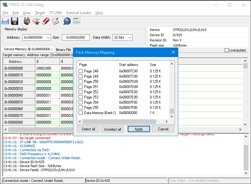

Using the old ST-LINK utility it was possible to erase the EEPROM using the Flash Memory Mapping window, shown below:
Note the entry at the bottom of the list is labeled "Data Memory (Bank1)" and is 1 KB in size. This is the EEPROM in the part.
However, the same function in STM32CubeProgrammer doesn't show that "Data Memory" selection. This should not require use of an external loader, since the EEPROM is inside the MCU.
Would it be possible to submit a feature request to show the EEPROM as a selection in STM32CubeProgrammer similar to what was in ST-Link? It could be at the bottom of the "Erase flash memory" tab list, or better yet, add a tab labeled "Erase EEPROM" which would appear any time the connected target MCU contains EEPROM in its memory map.

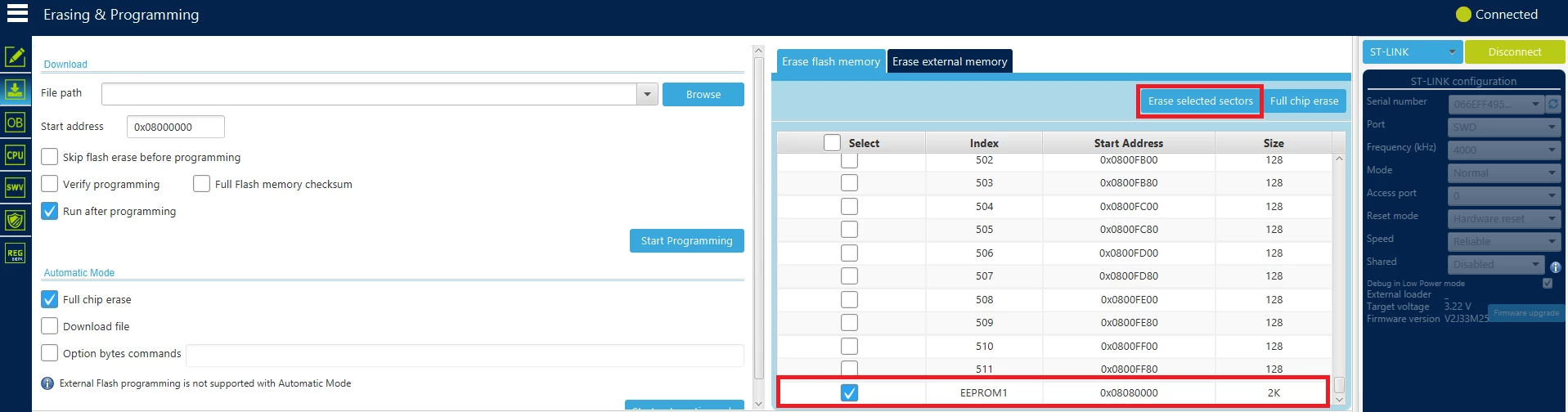

Maryem
December 6, 2023
Hello @EdFeten,
Thank you for your feedback and help.
You can also use the STM32CubeProgrammer GUI to erase the internal EEPROM. Simply navigate to the 'Erasing & programming' menu, select the EEPROM bank, and then click on the 'Erase selected sectors' button.
Maryem.
Explorer II
December 6, 2023
OMG!!
Thanks so much! *** me, I did not scroll all the way to the bottom of the "Erase selected sectors" screen. This is much more convenient than doing from the command line.
Thanks for your help,
Ed

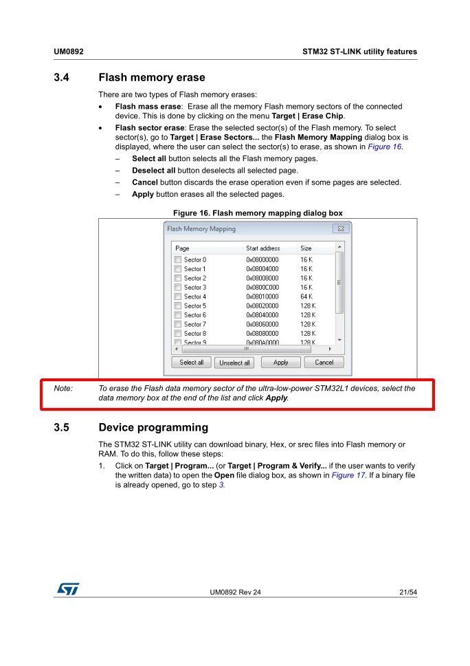

Hi @Maryem ,
Thanks for chiming in.
I think the key information here is, that in CubeProgrammer, EEPROM in 'L0 is treated as another FLASH sector. This is not at all obvious, so this should be hinted somehow: maybe putting it as first, rather than last, item in that list of sectors.
I now also looked at STLink Utility, and lo and behold, it's similar:
I then looked into STLink's User Manual, UM0892. Textual search for "eeprom" found it only once, in description of the command-line utility. However, there's also this:
So that would need to have 'L0 added, and also the word "eeprom" so that it can be searched for.
On the other hand, in the CubeProgrammer manual (UM2237 rev23), where again textual search for 'eeprom' finds it only in the CLI description (I guess  that's why @EdFeten knows about it and recommended it), the relevant Memory erasing subchapter of Internal flash memory programming chapter has no mention of "eeprom", "flash data memory", nothing. So that would need to be fixed, too.
