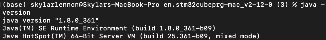

I am trying to download STM32CubeProgrammer on MacOS Monterey 12.6 in order to program a STM32F103C8T6 ARM (BluePill) microcontroller. I followed the directions on this post, but I'll outline what I did exactly.
I first uninstalled java:
sudo rm -rf /Library/Internet\ Plug-Ins/JavaAppletPlugin.plugin
sudo rm -rf /Library/PreferencePanes/JavaControlPanel.prefPane
sudo rm -rf /Library/Application\ Support/Oracle/Java/
sudo rm -rf /Library/Java/JavaVirtualMachines

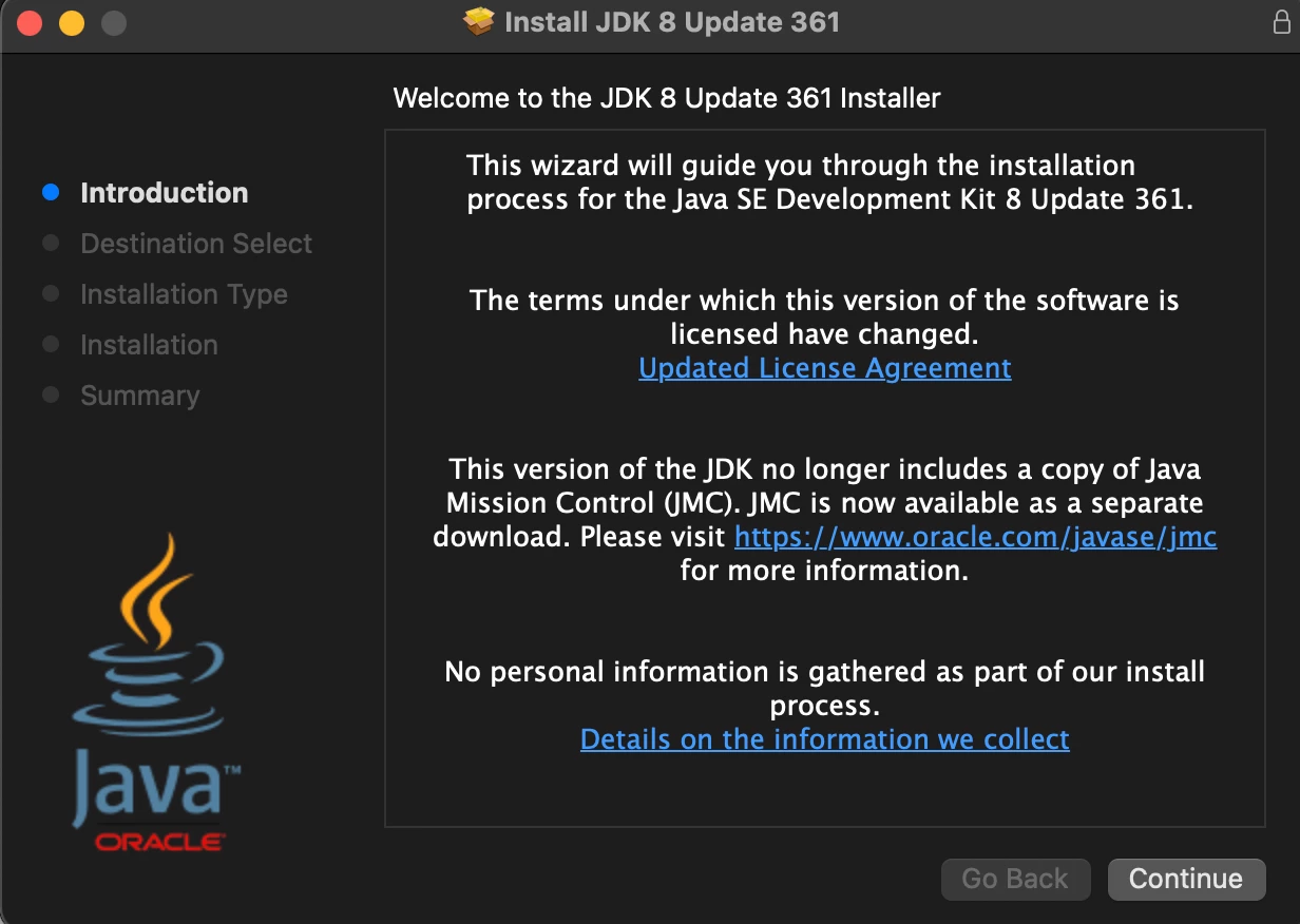

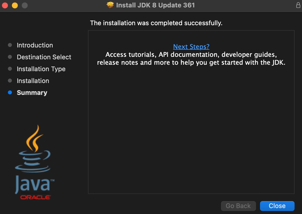

I then installed jdk-8u231-macosx-x64.
0693W00000Y8wg2QAB.png0693W00000Y8wgvQAB.png0693W00000Y8whPQAR.pngWhich downloads a different version of Java than the post I was following which I suspect could be part of the problem. I also didn't download the JMC separate download. Not sure if that matters.

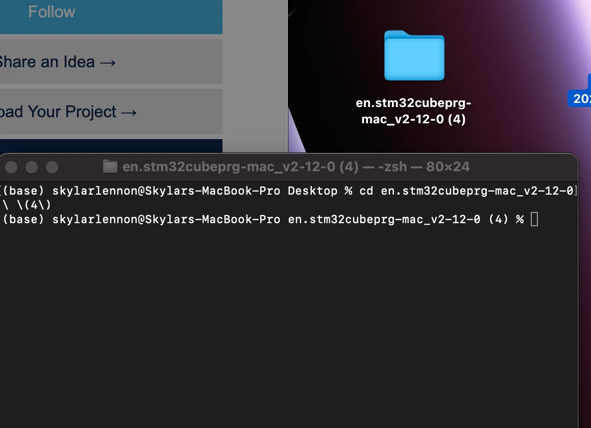

I then downloaded the STM32CubeProgrammer for Mac. Tossed the folder on my desktop, and changed directory to this folder
0693W00000Y8wiOQAR.pngI then ran the command:
sudo java -jar SetupSTM32CubeProgrammer-2.12.0.exe

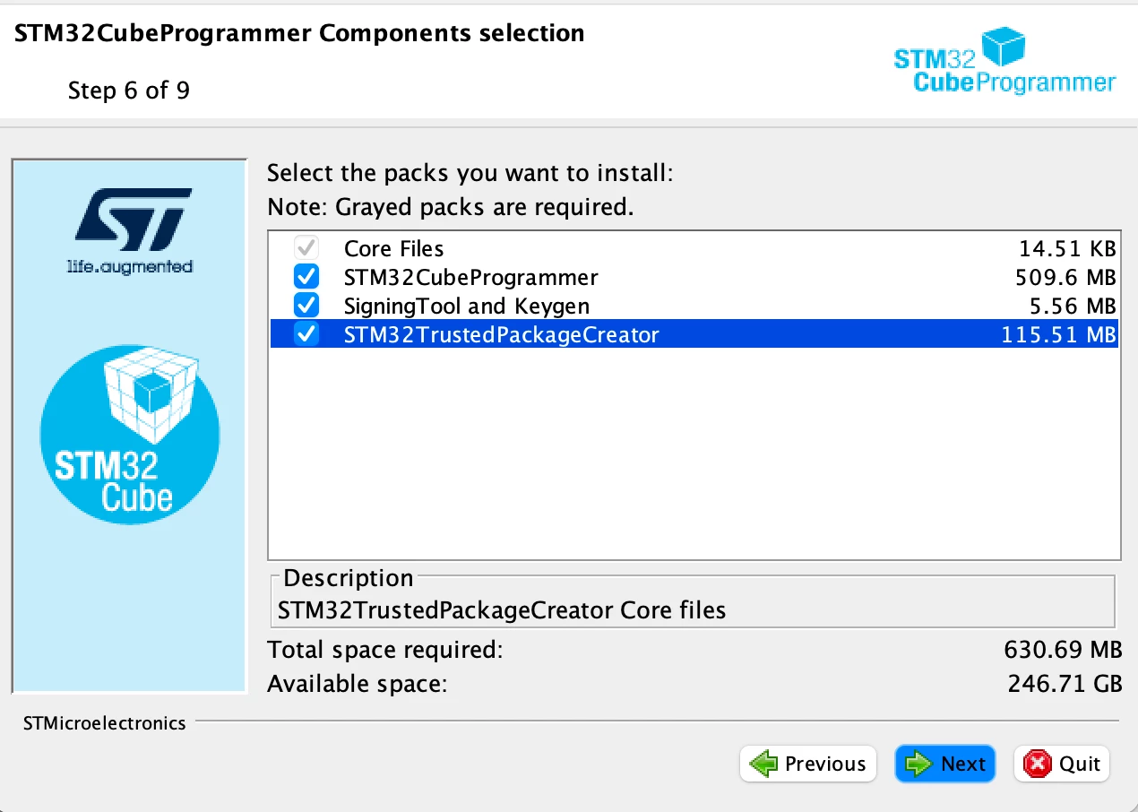

Which brings up the installation wizard for the STM32CubeProgrammer. I followed this and downloaded it to this default location:
/Applications/STMicroelectronics/STM32Cube/STM32CubeProgrammer
Downloaded these files:

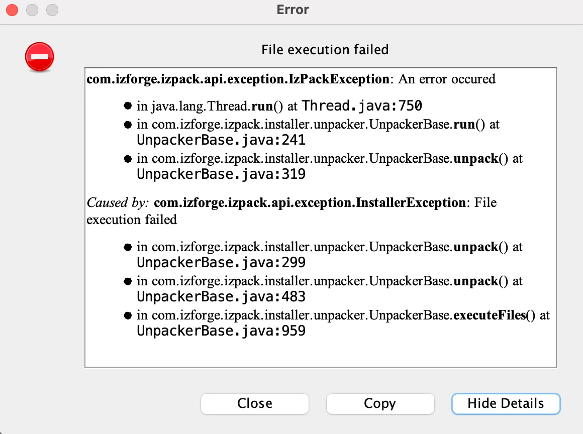

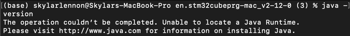

But it gives me this error:
With these details:

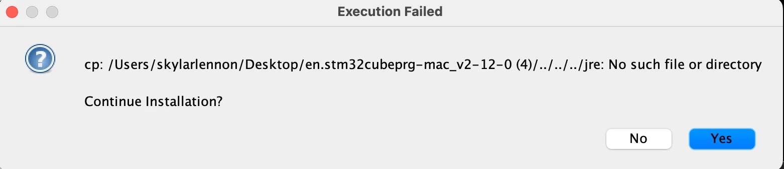

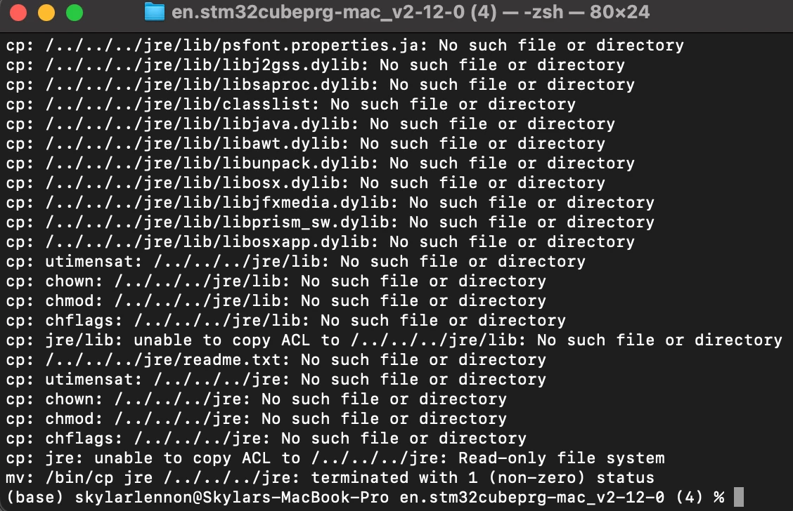

Not sure why it's looking for jre 3 parent directories back. I tried to move the jre file there but it's giving me this error:
0693W00000Y8woaQAB.pngWhat am I doing wrong? Thank you so much in advance for the help. This is for a school project team and I can really use the help.
Best answer by Sara BEN HADJ YAHYA
Hello @SLenn.2​ , @Community member​ , @TJone.5​ ,
Thanks for your feedback,
Adding to what my collegue @KHALSI_Foued​ referred to, you can also try one of the following solutions:
1- Install CubeProgrammer using the command:
sudo xattr -cr ~/SetupSTM32CubeProgrammer-macos.app
2- In case you used the .exe installer (sudo java -jar SetupSTM32CubeProgrammer-2.12.0.exe.) and the popup occurs during the install indicating the following:
cp: en.stm32cubeprg-mac_v2-12-0/../../../jre: No such file or directory
Continue Installation?
Continue the installation and copy the downloaded jre folder manually into the CubeProg install folder. To do so, please follow the steps below:
- Copy the jre folder from the downloaded en.stm32cubeprg-mac_v2-12-0
- Open CubeProgrammer install folder
- Right click on STM32CubeProgrammer.app and select "Show Package Contents"
- Paste the jre folder
3- After the install, if CubeProgrammer couldn't be launched via GUI, please try to lanch it via CLI as follows,
- Navigate to the /Applications/STMicroelectronics/STM32Cube/STM32CubeProgrammer/STM32CubeProgrammer.app/Contents/MacOs/bin/
- type the command:
java -jar STM32CubeProgrammer
- If the jre folder exists in CubeProgrammer install folder, type the following command:
../../../jre/bin/java -jar STM32CubeProgrammer
I hope this helps!
