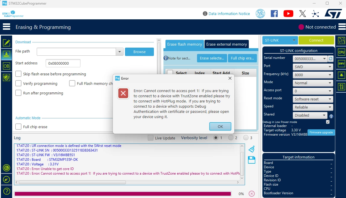

I just bought discovery kit for STM32MP1 and I have connected power and JTAG USB.
When I am clicking on connect, I am getting below error.
Can you please tell how to connect?

Hello @embeddedbro,
You can connect MPUs with STM32CubeProgrammer only via USB. To connect please follow the steps in this wiki:
Populate the target and boot the image - stm32mpu.
Aziz

Hello @Aziz BRIGUI
I was using USB (not JTAG) , sorry for confusion.

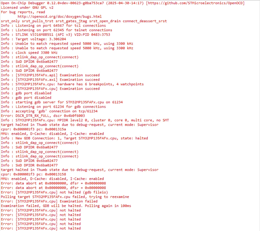

I also tried to put breakpoint in STM32CubeIDE and ran HelloWorld Program. But breakpoint was not hitting and there were lots of errors.
I was expecting that just after making BOOT settings and connecting 2 USB cables, I would be able to flash and debug the program but it was not possible.
