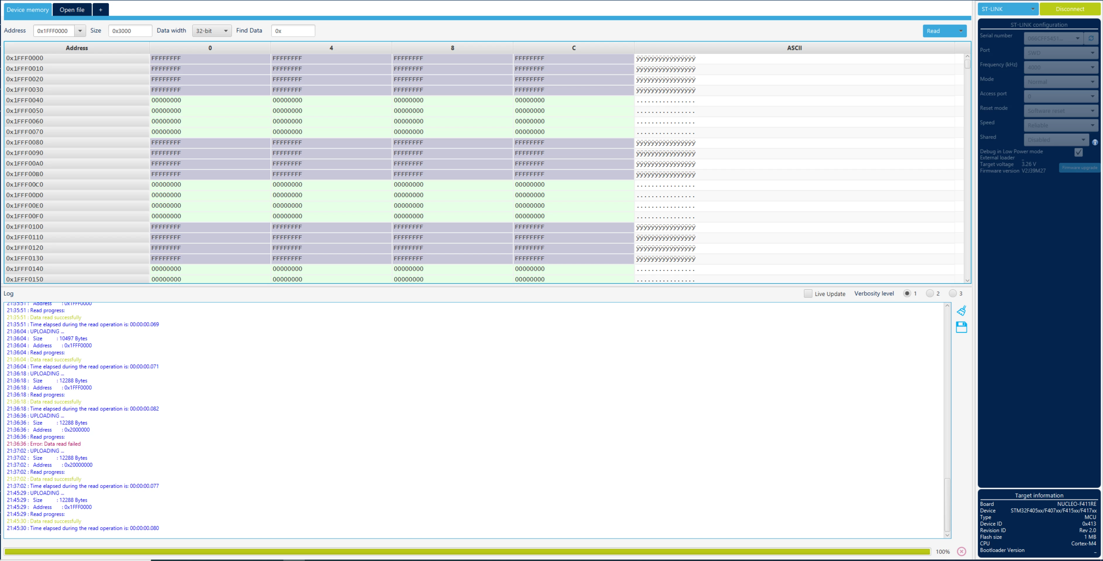

Hi I think my DFU Bootloader code in my STMF407VET6 i corrupted. Nothing happens when I pull BOOT0 high and start the device. Look at the attached screenshot. Is it supposed to look like this?
4 replies
Apr 26, 2022 9:56 PM UTC
No, it shouldn't look like that.
You're using the programmer on the nucleo board to connect to an external custom board?
If you can otherwise use the chip by programming/reading/erasing the flash and it behaves as expected, perhaps you have a dud chip. Perhaps a half-baked clone.

Yes, using nucleo externaly.
I can program the chip and add applications to 0x08000000.
Is it possible to flash the bootloader binaries over or is the chip dead?
Apr 27, 2022 2:20 PM UTC
The bootloader is in ROM and cannot be modified in any way. This also means it cannot have been erased.
Apr 27, 2022 2:21 PM UTC
If I were you, I would read out values around 0x1FFF0000 within my code to double check what STM32CubeProgrammer is telling me.
