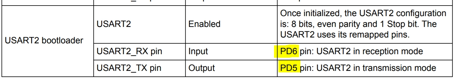

Hi. I have been trying to flash an STM32L152RD (STM32L1xxxD) using the CUBE programmer through the USART2 and it never connects (Timeout error occured while waiting for acknowledgement). I have used the software method of branching into the bootloade
Because I do not have access to the BOOT0 pin (custom board, not eval board) I have used the software method of branching into the bootloader : https://stm32f4-discovery.net/2017/04/tutorial-jump-system-memory-software-stm32/
I have adpted this code for the device (notably bootloader address 0x1FF0 0000)
USART2 physical pins are PA2 and 3
My questions are:
  1. Is the bootloader code listening to USART2, is it listening to everything? Or does this require a specific configuration?
  2. Do I need to configure the USART2 with baudrate etc. before jumping to the bootlaoder so that it corresponds to the CUBE->UART settings or is this an automatic process?

Got anything chattering on USART1? Or other used pins?
Doesn't it expect USART2 signals to be on PD5/PD6?
AN2606 https://www.st.com/resource/en/application_note/cd00167594-stm32-microcontroller-system-memory-boot-mode-stmicroelectronics.pdf

Jan 8, 2021 3:10 PM UTC
I think you're missing what @Community member​  is saying.
> Yes Tesla, but my debug/interface port is on PA2 and 3. (USART2 has several mappings).
This was doomed at the start. The USART2 bootloader isn't on PA2/PA3, it doesn't matter if those pins can be used by USART2 if the bootloader isn't listening on them.

Jan 8, 2021 3:18 PM UTC
Tesla DeLorean I think you are right about the PD5/6 pins and this is why the "standard" bootloader is not talking to CubeProgrammer. I have provoked bootloader execution by clearing the flash and pulling the BOOT0 pin high (in this case it is available but in final package it is not). And still no COM on USART2 PA2/3. I think the pre-installed bootloader only listens to PA10/11 USART1 and PD5/6 USART2.

Jan 8, 2021 3:22 PM UTC
TDK Yes you are right, therefore I will have to code a bootloader myself that talks to those pins until we do a re-design of our board. Thanks again for your help!

Jan 8, 2021 4:52 PM UTC
I have now flashed using IAP with the USART2 mapped to PA2/3, no issues. My app at 0x80004000 (2 changes, FLASH_BASE and ld file).
