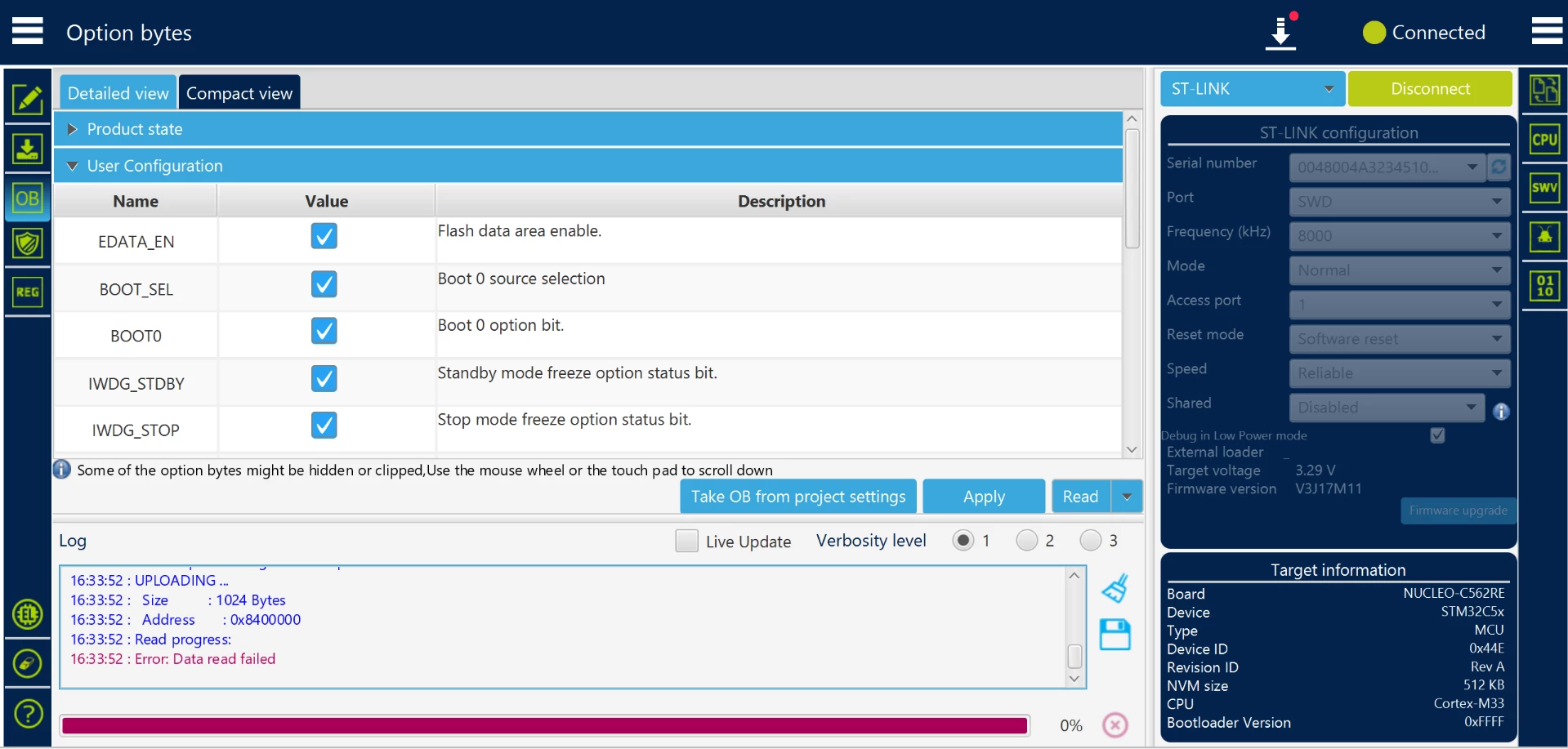

Sep 16, 2026 7:19 AM UTC
Hi ​@Amine_Jridi

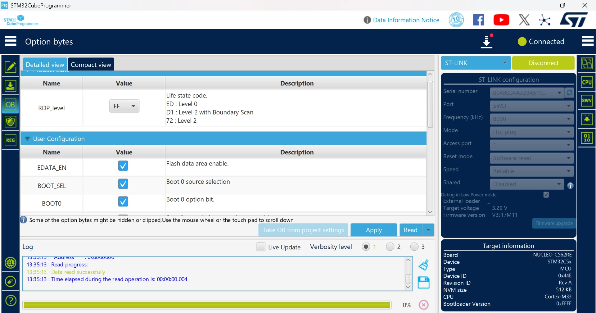

Yeah sure, I am attaching a SS of option bytes of that board

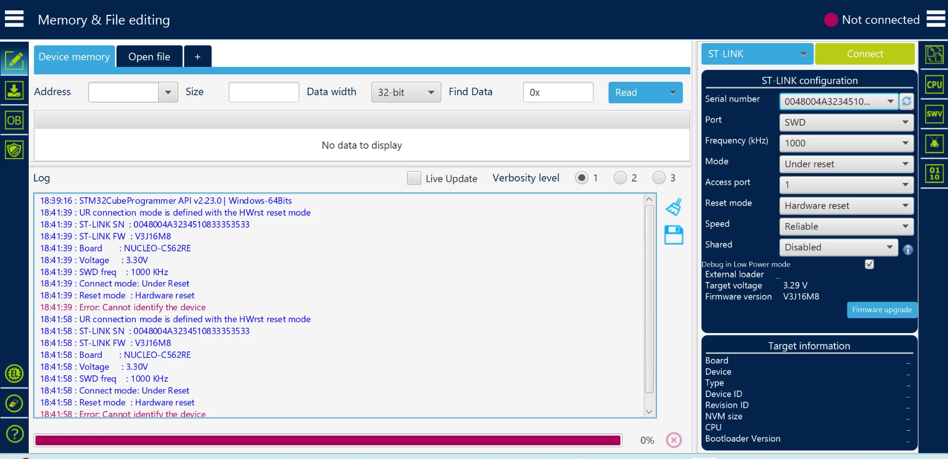

and first, I was at the latest version v2.23.0 but I was not able to connect with ST-Link and the error was can not identify the device. I am attaching the SS of that also in 184225.png
So, if anything with latest info, just help me out!
Thanks & Regards!
Amine_Jridi
Sep 18, 2026 2:29 PM UTC
Hello ​@Vishalpandey,
The only difference I can observe is that you are using an old cut chip with no bootloader version (0xFFF), and that can explain the error in v2.23. Could you try with a new chip?
Thnaks,
Amine.
