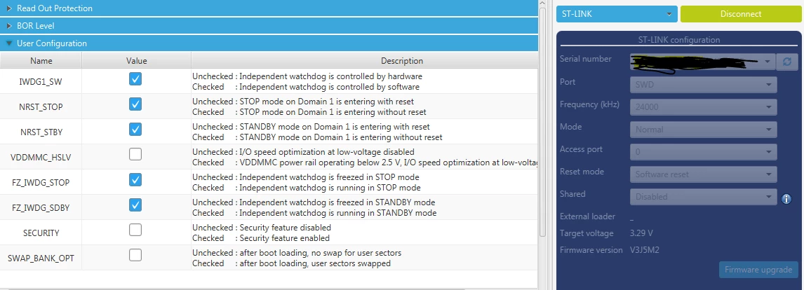

Not sure what I am doing wrong but when I program my STM32H7B3I-DK board with STM32CubeProgrammer, all seems fine, the application start to run and everything is okay.
The problem occurs when I click the Disconnect button and later then try to Connect at this point what everything I have programmed in the flash memory of device gets erased.
I am running the Secure Boot Secure Firmware Update (SBSFU) example program. Below is an image of my "Option Bytes" I can't see any of the flag to cause this behavior.

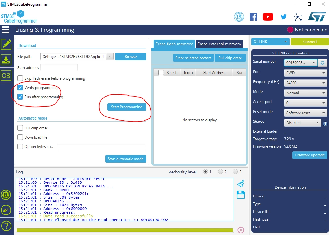

Okay I misread what you said about RDP. Yes you are correct when I flash the chip with the SBSFU firmware it sets the RDP to level 1. It also sets PCROP and Write Protection on some sectors
However there is a standalone Loader application that can run independently of the SBSFU firmware, this project does not affect any of security bits I mentioned in paragraph above.
When I flash the device with STM32CubeProgrammer see image below the application starts to run immediately as set and shown in the image highlighted in red.0693W000003Q2m6QAC.png
However when I power cycle then it stops and when I connect to see contents they all show up as 0xFF which means blank.

The RDP level applies to whole MCU memory, not some sectors or ranges. Apparently the software shows 0xFF for unreadable memory. Your firmware is there, you just cannot read it with external tools - that's the whole purpose of RDP (ReaDout Protection). :)
Not starting is another issue. The "Run after programming" feature probably starts your code directly bypassing the bootloader, but after that normal reset starts bootloader. With SBSFU there are signature involved - that must be valid.
Also, after setting RDP (even if SBSFU does it), the MCU requires not only reset but a power cycle.
