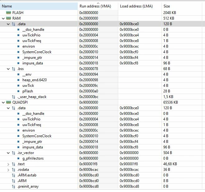

Hello all,
I modified my .ld file as:
MEMORY
 RAM   (xrw)   : ORIGIN = 0x20000000,   LENGTH = 512K
 FLASH   (rx)   : ORIGIN = 0x8000000,   LENGTH = 2048K
 QUADSPI (rx) : ORIGIN = 0x90000000, LENGTH = 64M (added line)
And I replaced  FLASH with  QUADSPI in order to load all to external flash.
I copied MX25L512G_STM32F769I-DISCO.stldr file to external loader folder of CubeMXIDE.
I modified system_stm32f7xx.c to set 0x90000000L offset:
 /* Configure the Vector Table location add offset address ------------------*/
#ifdef VECT_TAB_SRAM
 SCB->VTOR = RAMDTCM_BASE | VECT_TAB_OFFSET; /* Vector Table Relocation in Internal SRAM */
#else
 //SCB->VTOR = FLASH_BASE | VECT_TAB_OFFSET; /* Vector Table Relocation in Internal FLASH */
 SCB->VTOR = 0x90000000L | VECT_TAB_OFFSET; /* Vector Table Relocation in Internal FLASH */
#endif
When I debug the program with STM32CubeIDE
with external loader (MX25L512G_STM32F769I-DISCO, 0x90000000, NOR_FLASH, MX25L512G_STM32F769I-DISCO.stldr) my program reaches 0x90000000 and executes the code.
When I reset program (e.g. by button) or try to download program with STM32 ST-LINK Utility or STM32CubeProg... my program does not start.
https://github.com/rudoq32/STM32-QSPI.git
Do you have any useful hints for me?
Thank you
Rudo

You'd need code running from internal flash to stand-up the external interface before the processor can access it. That code would then need to transfer control to the image in external memory.
The CPU will start from 0x00000000, and thus your code in FLASH 0x08000000 that gets mapped their initially.

This is a Horse+Cart scenario, you've built a Cart, now you have to put a Horse in front of it.
The Horse would be a small loader app, that you might want to build separately, that resides at 0x08000000. It contains the code to set up the clocks, set up the QSPI (using the BSP code for the F769I-DISCO), and then transfers control to your image at 0x90000000. Your main app should then avoid messing with the clocks or QSPI interface again.
Perhaps look at some of the IAP examples where the boot loader and application sections are split into two pieces.
