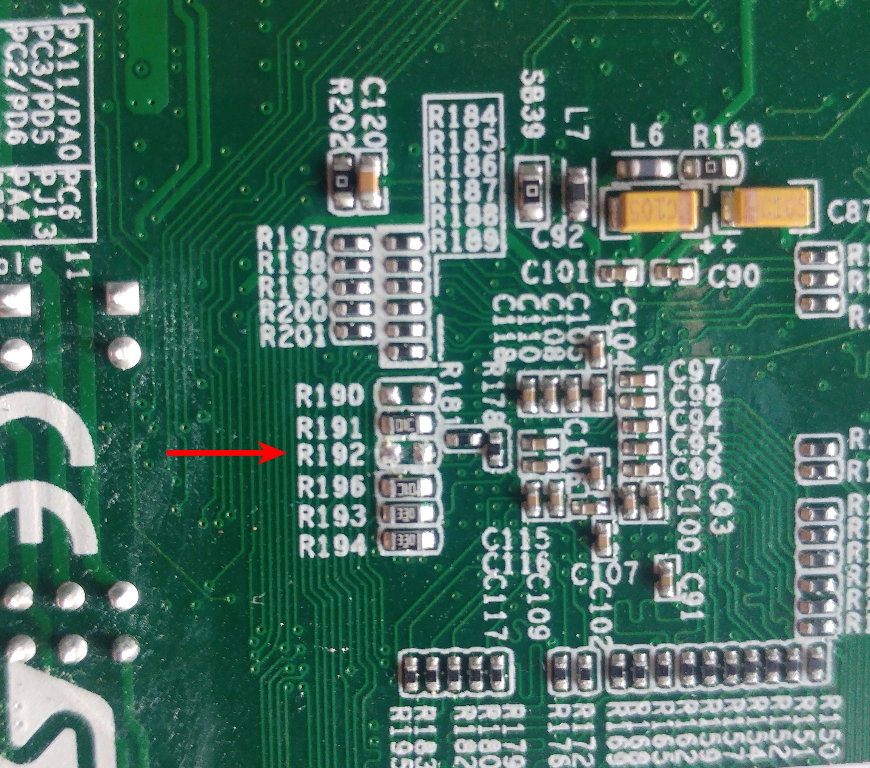

I try to connect to target STM32H747I-DISCO but show this message:
08:58:19 : ST-LINK SN : 004800413137510D39383538
08:58:19 : ST-LINK FW : V3J3M2
08:58:19 : Voltage : 3.27V
08:58:19 : No STM32 target found!
08:58:20 : ST-LINK SN : 004800413137510D39383538
08:58:20 : ST-LINK FW : V3J3M2
08:58:20 : Voltage : 3.27V
08:58:20 : Error: No STM32 target found!
And the file in FAIL.TXT with:
The interface firmware FAILED to reset/halt the target MCU
how can I solve that?
Best answer by Tesla DeLorean
Sounds like an issue with LDO/SMPS or VOS settings.
Topic covered previously.
Likely will need to jumper BOOT0 HIGH and cycle power several times until you can access flash and erase errant code.​
Ericson Joseph
December 13, 2019
Thanks you very much,
In STm32H747I-DISCO the BOOT0 is connect to R192 and this one to + 3.3V. View image
Solved.

Yes, sorry was responding on phone earlier, too hard to track down and paste links
https://community.st.com/s/question/0D50X0000Bh5aWoSQI/stm32h747-discovery-kit-not-debugprogrammer
Having bricked my board within having it a few minutes running H743 code I know the issue. I had advised ST (perhaps 18+ months ago) to have a top-size/user jumper on this because it was such a PITA to deal with.
