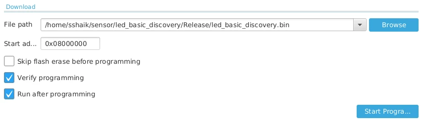

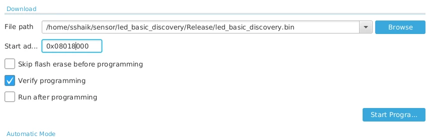

I am using LED blink firmware generated using CUBE-MX by Disabling all the modes and Clearing the pinouts.
I flashed one firmware in the bank-1 (0x08000000) and
second firmware(with few changes the way the led blinks) flashed into the bank-2 (0x08018000) using the stm32 programmer.
First I writing the firmware-2 into bank-2 like this.
Next I am flashing the firmware-1 in the bank-1 and running .
0693W00000BbKpCQAV.pngI kept the bank switch logic in firmware-1.
