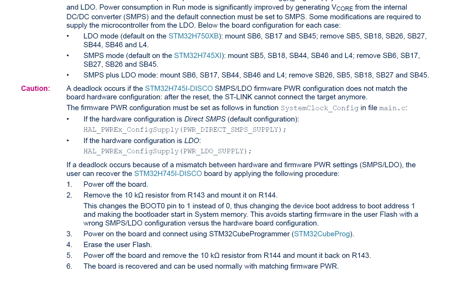

Deadlock on STM32H745I-Disco board and it Throws error "No STM32 target Found" in STM32CubeProgrammer
Deadlock on STM32H745I-Disco board .
The STM32H745I-Disco board Throws error "No STM32 target Found" in STM32CubeProgrammer .
Can we recover this Board if the TAG connector is connected to SEGGER DEBUG Adapter

With BOOT0 pulled high, cycle the power several times until you can attach and erase the program in Flash.
Check the LDO/SMPS and VOS settings in your code carefully so they don't jam up the board in this fashion.​

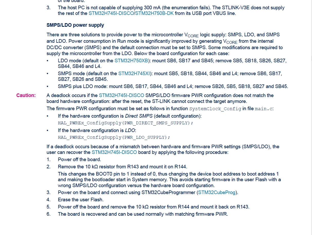

Yes the STM32H7 was Bricked , I am able to now recover the board 10K resistance De-Soldered from R143 and Soldered on to R144 .( There should have been an Jumper provided or ,, the ST-LINK should have had GPIO method to recovered the board )
0693W000004Jt3OQAS.pngAfter Going through the user manual it is mentioned in an Caution: :sad_but_relieved_face:
