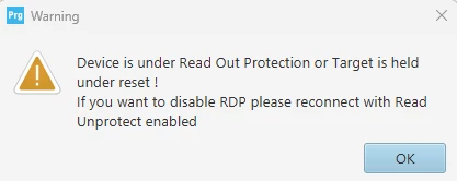

I am working on one customized DFU on my controller, the procedure is working now. I can jump to application without touch user button, and the procedure will go to DFU mode when user button is pressed. However, when I am DFU mode, I open stm32 programmer, the programmer has detected DFU mode on USB OTG, but when I try to connect controller, I got the following screen:

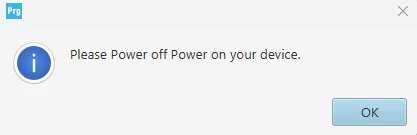

when I check “reading unprotection”, I got the following screen shot:

I got programmer log when I try to connect controller as shown below:

11:14:36:392 : unable to switch the device to dfuIDLE/dfuDNLOAD_IDLE state

11:14:36:396 : Warning: Device is under Read Out Protection or Target is held under reset
11:14:36:396 : Device Read Unprotect requested

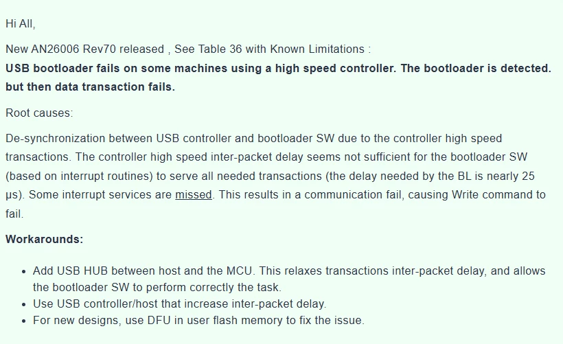

Please check the link below:
I have exact issue like above. DFU mode is detected, but reading is failed. the guy added a usb hub to solve the issue, but for me, I am not lucky, I can’t fix the issue even I put usb 2.0 hub.
So I would like to know whether ST has any update for this issue?
